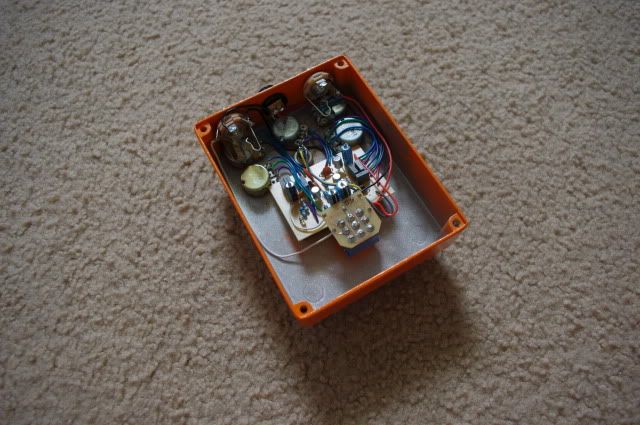

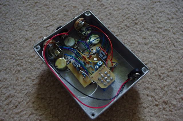

Also, here's something new.
I got this pedal (lunar module deluxe clone) in trade and it had no finish and a few off center holes. Since it would be easy enough for me to fix I went to town.
Before :
After a fresh powdercoat finish and fixing the drill holes :
The internal wiring isn't as clean as I'd like (but you've seen my OCD builds :lol:) it but it works and nothing looks like it would ever be faulty so I just left that be for the most part (went over a few of the jack joints, shortened a few pot wires, and ditched the battery snap)
