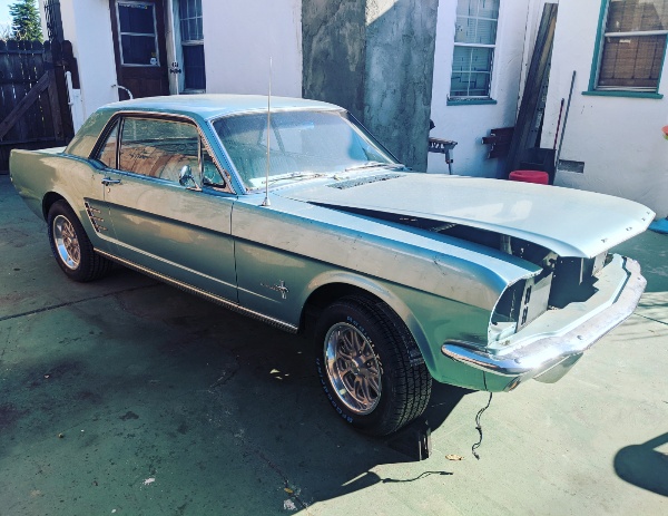

Got the suspension on the mustang. Insane day and a half of doing that in between of like six other things. Did the rear end, front suspension, arning drop, could springs, leaf springs, changed wheel bearings (to add spacers which was nuts because my new bearings were wrong), disc brakes all around, sway bar, Monte Carlo bar, Bilstein shocks all around, new wheels, new cross member, new steering box, upgraded steering, and adjustable bump steer. Now to pull it off and finish painting now that I moved it to the back yard haha.
All to get disc brakes and 5 lug wheels.
Also did the stucco behind it. And half painted those window trims.
Picture is too small, but I put Moroso and Bilstein stickers on the door window.
Built three flower beds too. Just redwood, but they look ok.

Wow. How did you do all of that in a weekend? I'm so jealous of your productivity...
lordgalvar
Posts: 6165
Re: The Automotive (& other mechanized vehicles) thread
Post by lordgalvar »
It's not as impressive as it sounds.
The car was a Thursday/Friday thing. Saturday was moving it (which is crazier than it sounds because I only had 3" on either side and the garage is kind of too short). The previous sat-wed was everything else. Only mentioned the stucco and paint because they are in the picture.
Working on cars is easier when it's stripped of everything which I did over a year ago.
The six other things was like keeping family entertained and other stuff like that haha.
