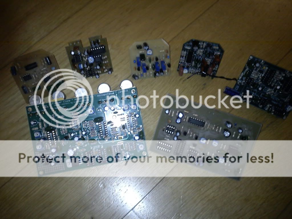

Not quite finished but I just spent the evening having a mammoth soldering session before I try and move away from the hobby... just one (Secret) massive pedal left to do tommorow... but you'll never find out what it is! Muwahahaha.
Left to Right...
Top Row - DOD 230 Noise Gate, Small Clone, FET Distortion, Acoustic Simulator Pedal & a Bad Stone Phaser
Bottom Row - A/DA Flanger & 9V Electric Mistress.
tuffteef
Posts: 7890
Location: Downunderverse
Post by tuffteef »
i still havnt built my bad stone phaser :lol:

Post by Scruffie »
tuffteef wrote:i still havnt built my bad stone phaser :lol:
Awww, you should, this isn't my first one, it's a great sounding phaser, I don't even really like phase that much but love this one... really wanna make a mini version to fit a 1590B.
Are there any of those still available?...goes and checks site...
Scruffie
Admin
Admin
Posts: 4647
Location: London.. ish, Uk
Post by Scruffie »
Jero wrote:
If there are it's like... one or two i'd guess by now.
