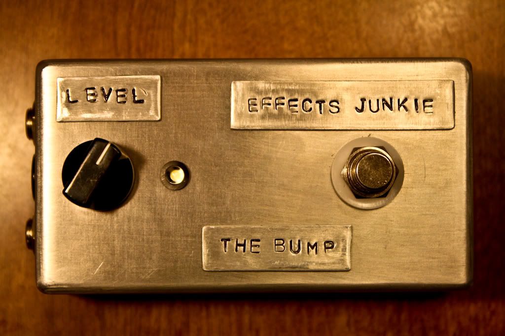

GGG CB-1 build. I just E6000'd the labels on before taking gut shots. Once they set up (24hours) I'll take inner shots.
This is my first attempt at building anything electronic.
GGG forgot to include an LED nor did they provide any specifications in the build literature,...so I bought a bright LED from Radioshack,...and either I reversed the polarity or the resistor in the circuit is not letting enough power to the LED. I'll admit that I'm ignorant to how that works so any enlightenment is appreciated. :thumb:
Other than that it works,...so I'm excited to have a 90% successful build (sans the LED). I'm going to be putting together a Beavis Board for my next project and start working on my own circuits instead of buying kits. :yay:
I also have access to a powder coating setup so I'll probably start doing that instead of just the bare metal finish. This CB-1 looks very home built.

eatyourguitar
Posts: 3127
Location: USA, RI
Post by eatyourguitar »
you gots your LED backwards
warwick.hoy
Posts: 5226
Location: Spokanistan, WA
Post by warwick.hoy »
eatyourguitar wrote:you gots your LED backwards
All signs point to this. I expected at least one mistake on my first build. But hey,...no hockey shenanigans on the decorations. :lol: :thumb:

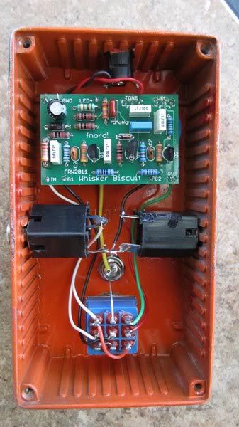

This is my test build of the Whisker Biscuit PCBs I just had made. Here's the original page at runoffgroove:
http://www.runoffgroove.com/whisker.html
Everything is working like a charm. PCBs will be up for sale soon (link in my sig below).
This is one mean-sounding mama. 8) If you love Muffs, you'll love this one.
I went a little wacky with the paint this time.
mathias
Posts: 3868
Location: noosphere
Post by mathias »
LEDs are a type of diode -- they only let current flow in one direction, among other neat attributes.
The longer leg is almost always the positive leg. (unless it's already clipped or whatever)
Most LEDs are happy at 3V or 5V, so they typically are paired with a resistor to bring the voltage down to a safe range. Typically in a pedal with 9V power, a red LED will take a 470 Ohm resistor. (Give or take some -- people use other close values.) This may already be part of the kit's circuit, so look for that before adding one.

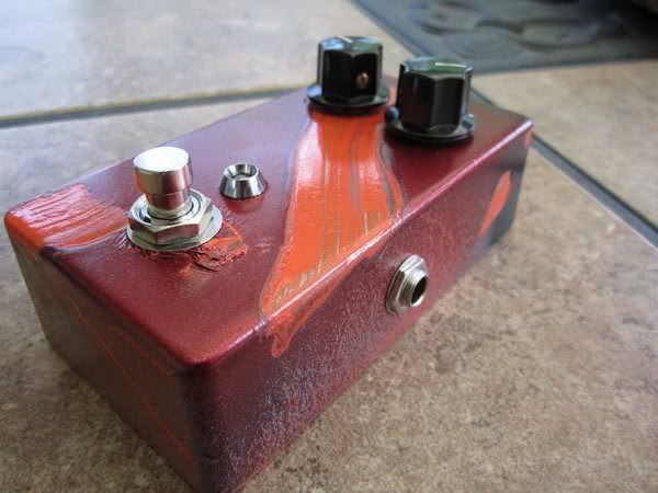

actually it's not a finished diy project yet, but an already finished paint job on an enclosure for a MagnaVibe clone
