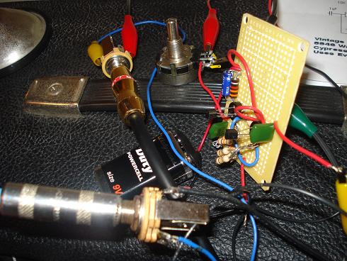

Not a board yet but getting there..
Adding a Sansamp Gt2 and a Fuzz clone(that is if i can i get it into the pedal housing)
Any suggestions on the signal chain?
And should the chain differ if going into a mixer for recording purposes?

First build STILL in the works... :cry:

I recently took this build (fuzz) apart as it stopped working once it was in the pedal box.
I built it again and it always seems to work on the breadboard
but the minute it goes on a circuit its dead.Its probally something really simple I just overlooked.
As far as the signal chain thats kinda what I figured but what would be a buffer?

comtrails70 wrote:I recently took this build (fuzz) apart as it stopped working once it was in the pedal box.
Scruffie wrote:I spy a piece of carbon comp mojo on that board...
What is the first build? Might be able to leand an hand...
Signal chain, Usually wah first then distortion next, modulation (Aka your whammy and delays and reverbs) at the end but swap them around and see what sounds best! (A good buffer at the end of a chain is always a nice addition to keep your high ends)
Shouldn't really be going straight into the mixer... but no.
My answer... it's grounding on the case... cut any bare wire shorter, cover the base of the enclosure in an protective substance (electical tape, laminate even cellotape will do)
Also if you make sure everyyy where it's not accidentaly gounding, an quick resolder of everything you soldered, to check it's a good connection also making sure there is no (accidental bridges or solder connections racross things that shouldn't be connected)
And as for buffers they can help keep your tone... some pedals have better buffers, BOSS pedals have crap buffers (in my opinion not others) which means they use an switch buttttt it's not true bypass (true bypass is the removal of the circuit when the pedal is off) so they can use an LED (without an expesnive 3PDT switch, where you can have True Bypass and the LED) Visual sound have an good buffer (worked on by the R.G Keen of Geofex.. an Guru of effects) True bypass has no buffer, find an good buffer circuit, board it, stick it in a pedal and it will remove the loss of signal that is removed due to the capacitance of a cable.

I think i might have been a bit careless about grounding.I figure I'll start from scratch and take my time and check it every couple of steps.
thansk for the info Scruffie! Im going to have to read it a couple of times :lol: to fully grasp it.
The sad thing is that I've used pedals for years and never really started to think about how they work or work together till now.The whole buffer thing is new to me.
