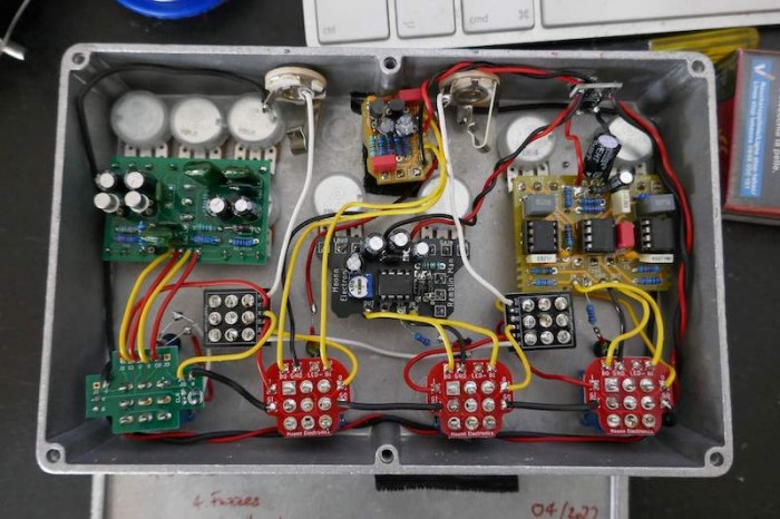

The white stripboard is super cool, and that little daughterboard for the pcb-mount pots is a nice touch as well.
Posted: Wed May 04, 2022 6:23 pm
by frodog
Thanks! Yeah those pots were the only B100Ks I had, so it had to be done that way, plus it made the power and ground connections a bit cleaner.

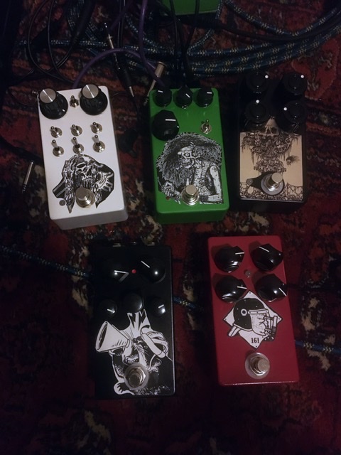

Here the works I did this weekend.
Top row are all Lastgasp Art Laboratories clones, built with Deadend FX PCBs: first a tweaked 88 (it's the third one I've built so far, first 2 being 1:1 stock, so for this one I changed 2/3 components to have a beefier sound and a different/wider oscillation range, no expression input and a 3 way diodes clipping switch Si-none-LEDs), Green Monster (I provided Dino the pictures to track this one, as I own the original, the clone sounds exactly like the original LAL, and the additional gain switch is very useful and expends all the rotten noises this pedal delivers), then a stock Octavella replica.
Bottom row are fuzz clones built with PedalPCB boards: left a EQD Black Ash (with few tweaks, like external pot for Q3 Bias, additional input Bass/Mass control borrowed from a Basic Audio schematic, and a Low/High gain switch on Q2) and right a Basic Audio Mutant Fuzz clone (all stock).

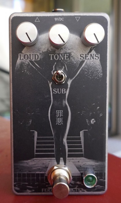

LAL Gomorrah, PCB from Deadend FX, a "subharmonic fuzz" as they say.
Sounds very cool on its own and absolutely amazing pushing bass heavy fuzzes like the Frantone Peach for example.
As for the graphics: it wasn't too far from Gomorrah to Sin City .....

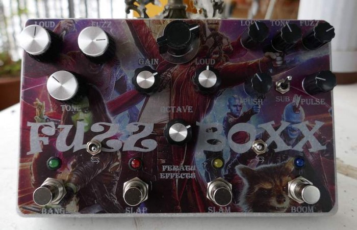

And while I'm at it, I think I forgot to post my FUZZ BOXX.
First half, so to speak, is a Mastotron (BOOM) and a Dark Meathead (SLAM), with an order switch.
Then there's an (LM386) octave fuzz (SLAP) and a Peach Fuzz (BANG), also with an order switch.
