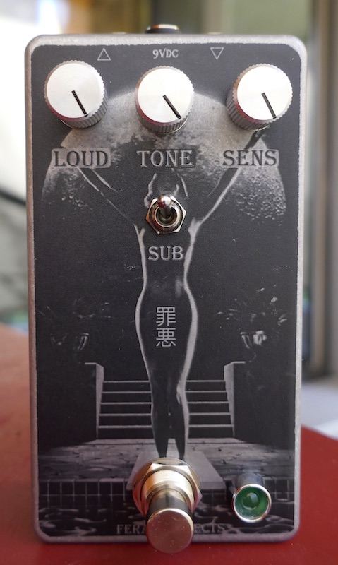

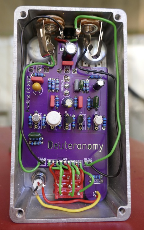

LAL Gomorrah, PCB from Deadend FX, a "subharmonic fuzz" as they say.
Sounds very cool on its own and absolutely amazing pushing bass heavy fuzzes like the Frantone Peach for example.
As for the graphics: it wasn't too far from Gomorrah to Sin City .....
green pilot light, obv

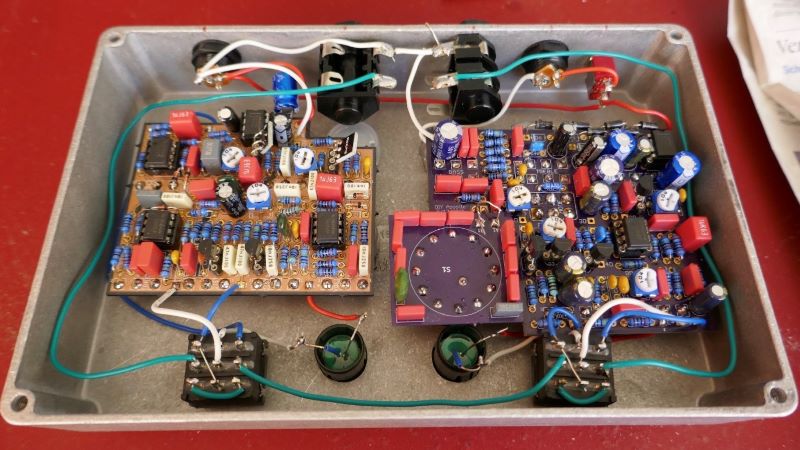

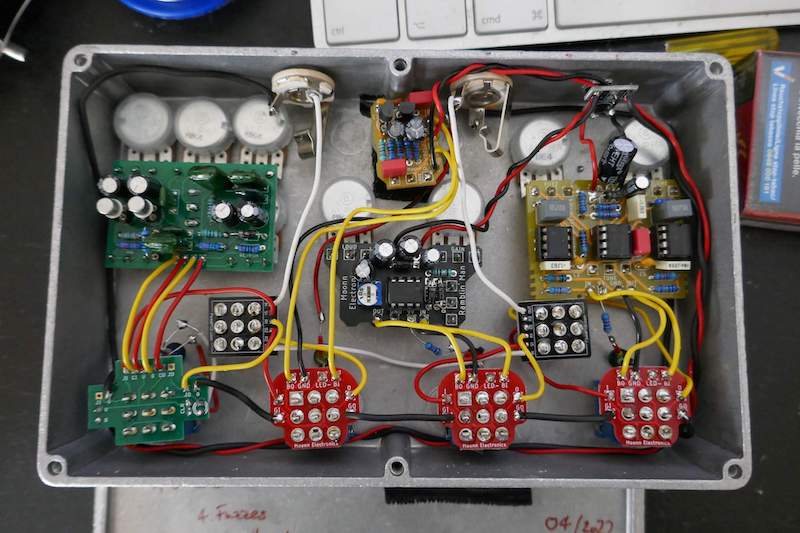

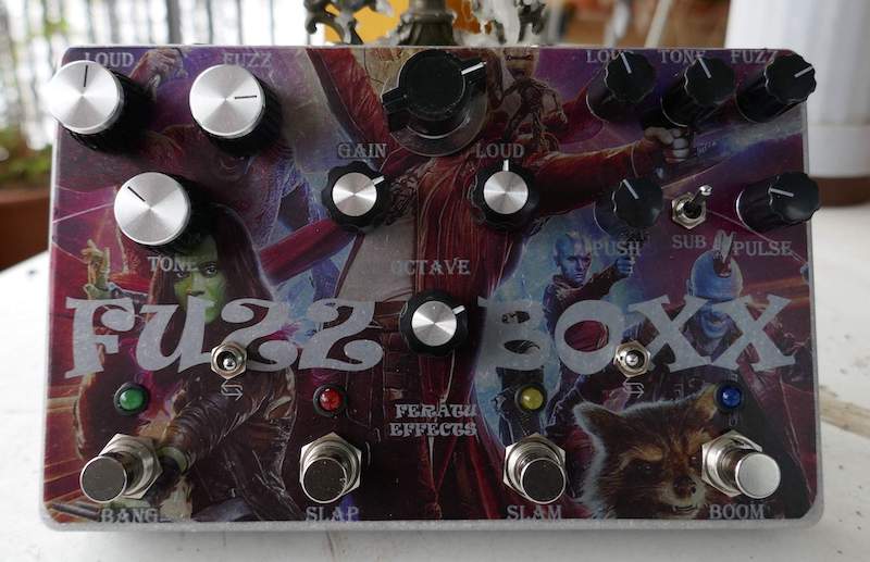

And while I'm at it, I think I forgot to post my FUZZ BOXX.
First half, so to speak, is a Mastotron (BOOM) and a Dark Meathead (SLAM), with an order switch.
Then there's an (LM386) octave fuzz (SLAP) and a Peach Fuzz (BANG), also with an order switch.
:animal:
fuzzzzzzzzzzzzzzzzzzz

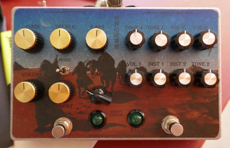

Post by fuzzonaut »
:hello:
:idk:
DESTROYER OF WORDLS, 2 Dunwich Designs, Cisneros Tone Generator (=DS1, DOD250 and a JFET clean boost in parallel) into Apostle, an Orange OR120 / Matamp GT120 emulation, running on 36V (MODE switches between the tone stacks of the 2 amps). Switch to use just one or both 9V inputs.
A BEAST!!! :animal:
follow me ...
follow me ...
... to the ...
... to the ...
And yes, I did change the Marshall knobs .... :facepalm:
