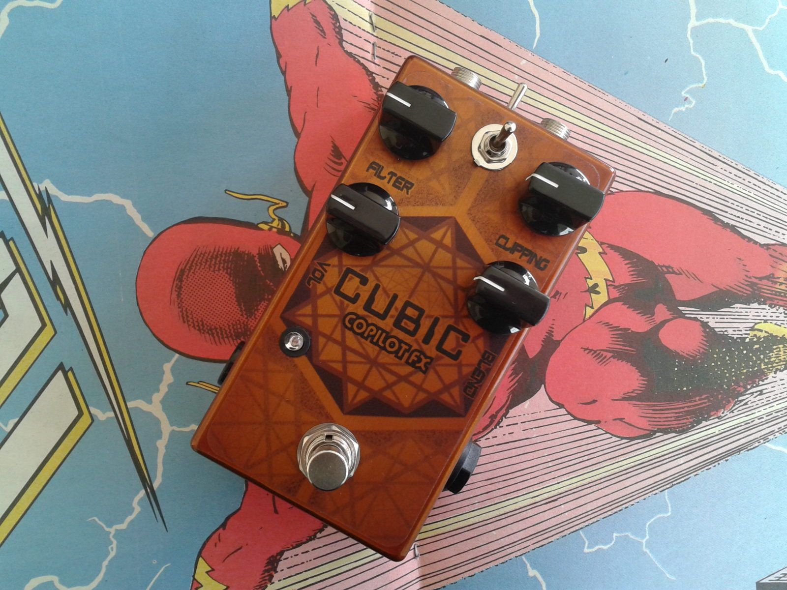

copper cubic (by request)

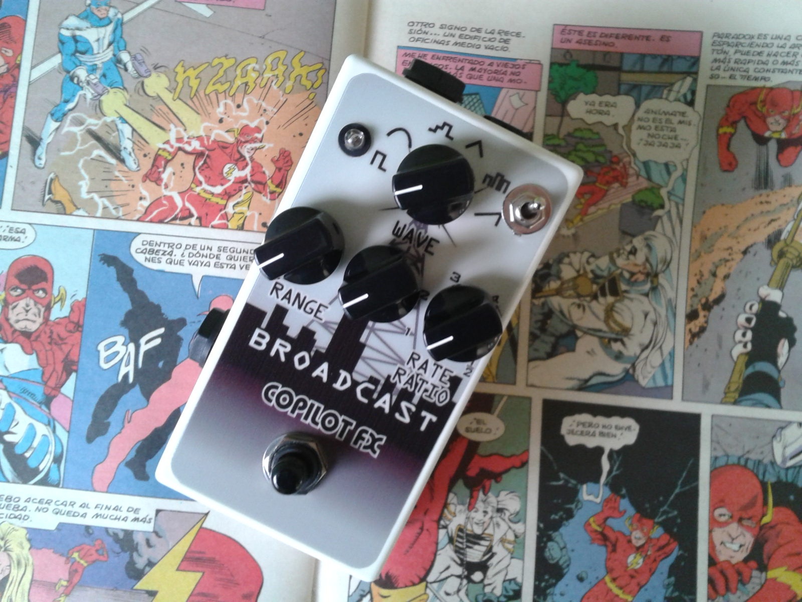

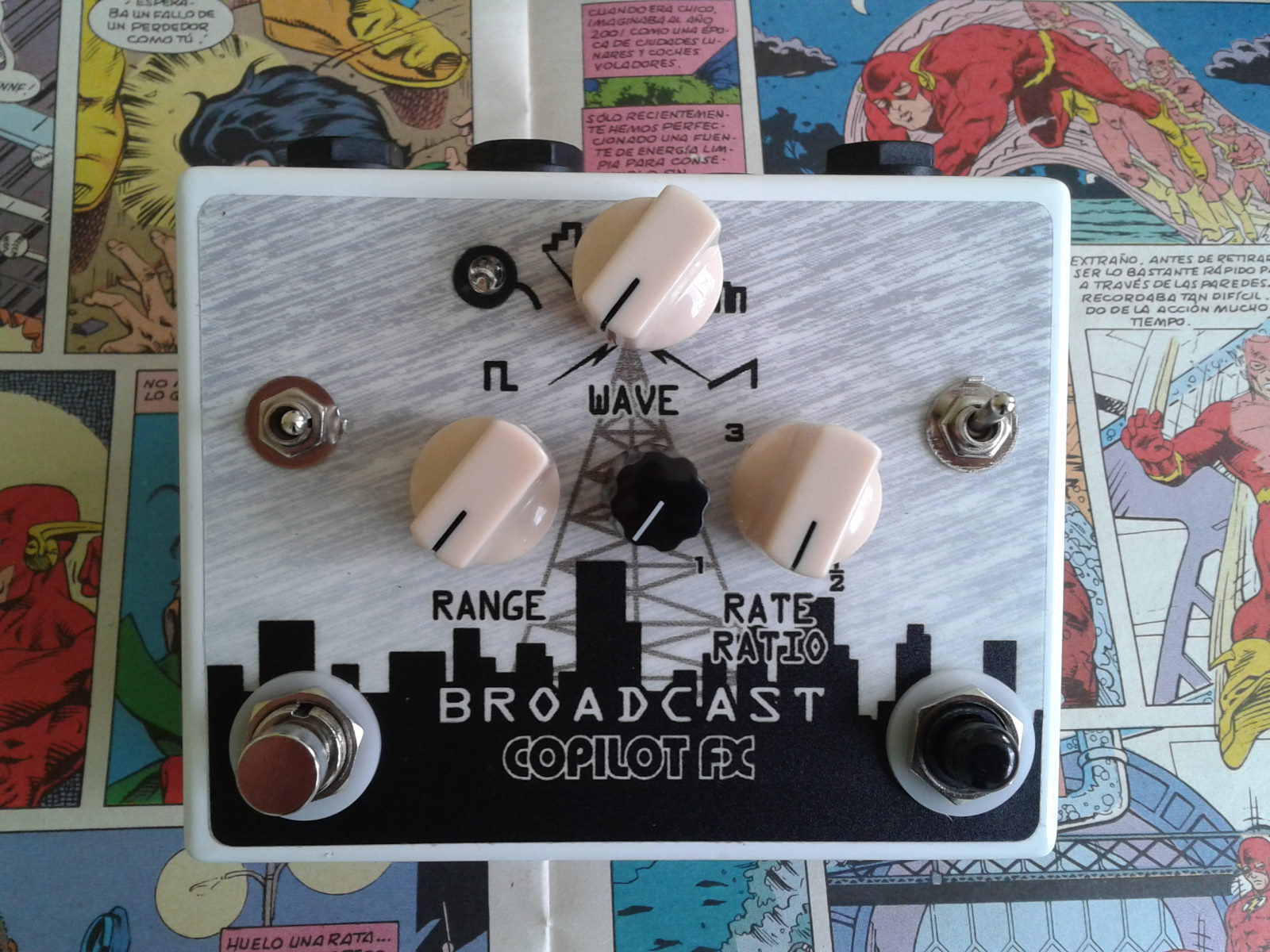

Custom Broadcast: Dual output, Expression in for manual control, footswitch selects if the main out is lfo modulation or manual , Right toggle is to select lfo or manual for out 2. Left toggle selects if is tap multiplier or normal speed control via the ratio knob. You can have both outs in lfo mode, both outs in manual mode, or one out in manual and the other in lfo and viceversa.

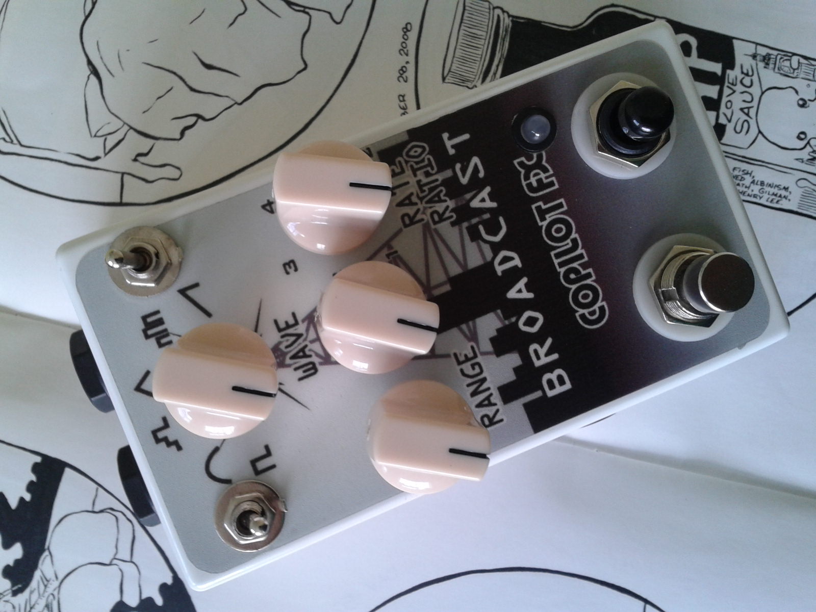

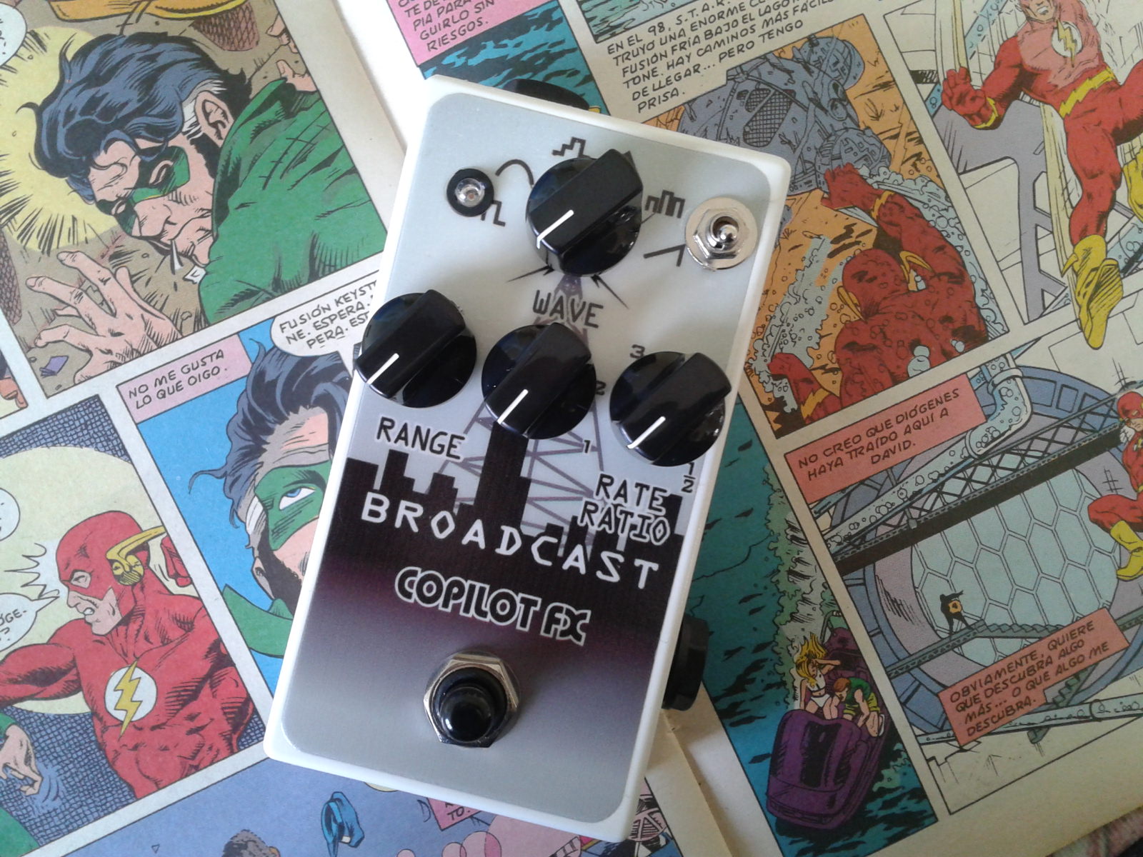

Custom Broadcast: Exp In for manual control and to adjust the ratio/multiplier (tap mode) or rate of the lfo. The ratio/rate control via external expression can be turned off by the right toggle.

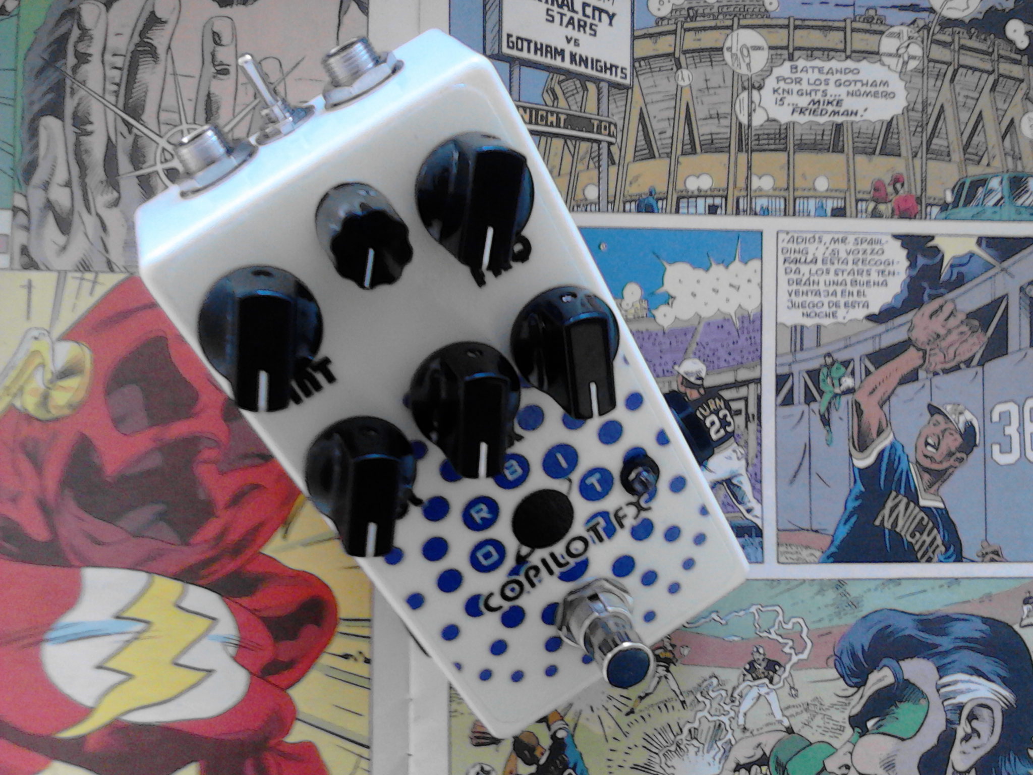

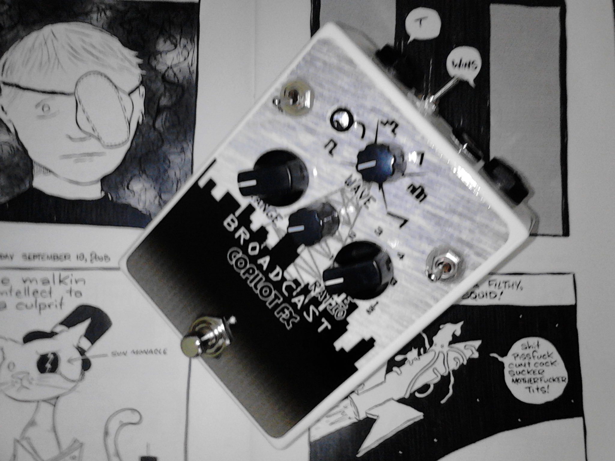

Another Custom Broadcast: Exp In for manual control and to adjust the ratio/multiplier (tap mode) or rate of the lfo. The ratio/rate control via external expression can be turned off by the right toggle. The led is red when is in lfo mode and green when is in manual mode

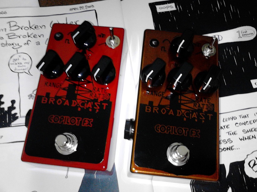

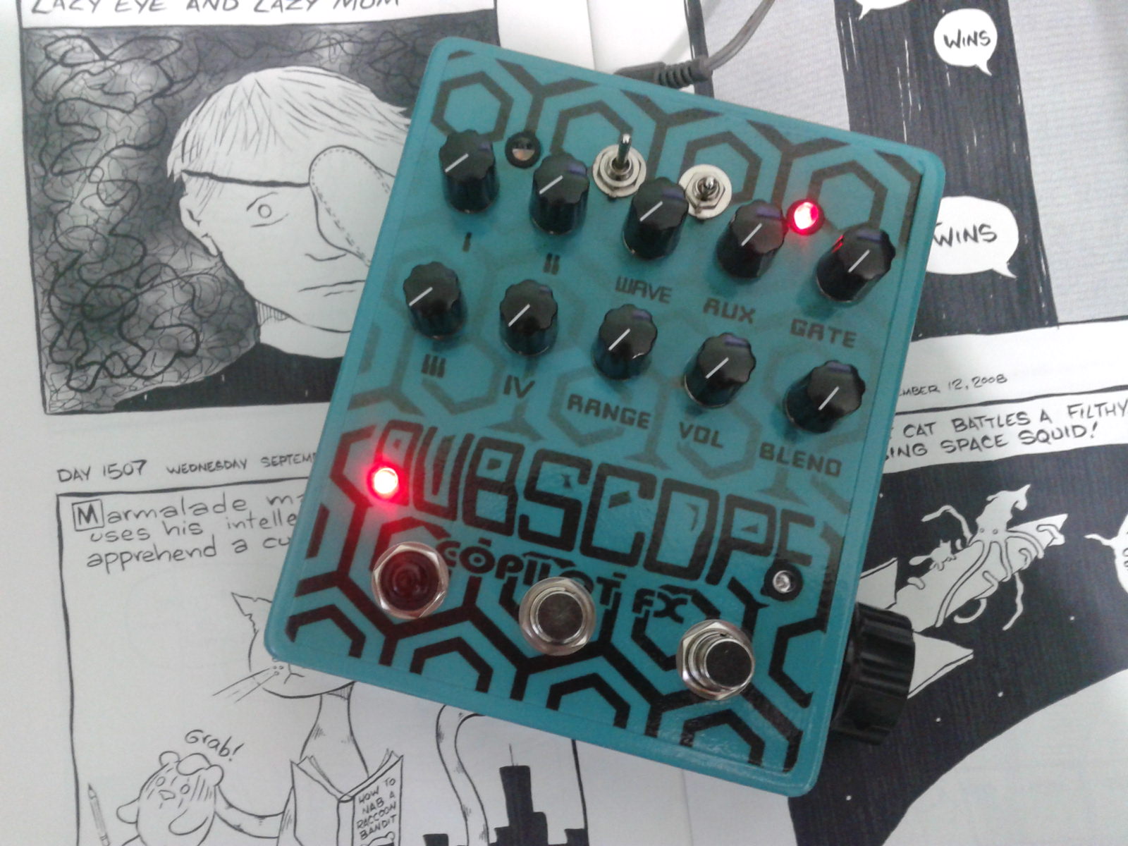

Supreme dubscope, you can use the filter section and fuzz interdependently (each side has their own footswitch), scroll mode toggle so you can change the steps manually (via the tap switch), the other toggle changes if the steps set the ratio multiplier (tap tempo) or set the speed

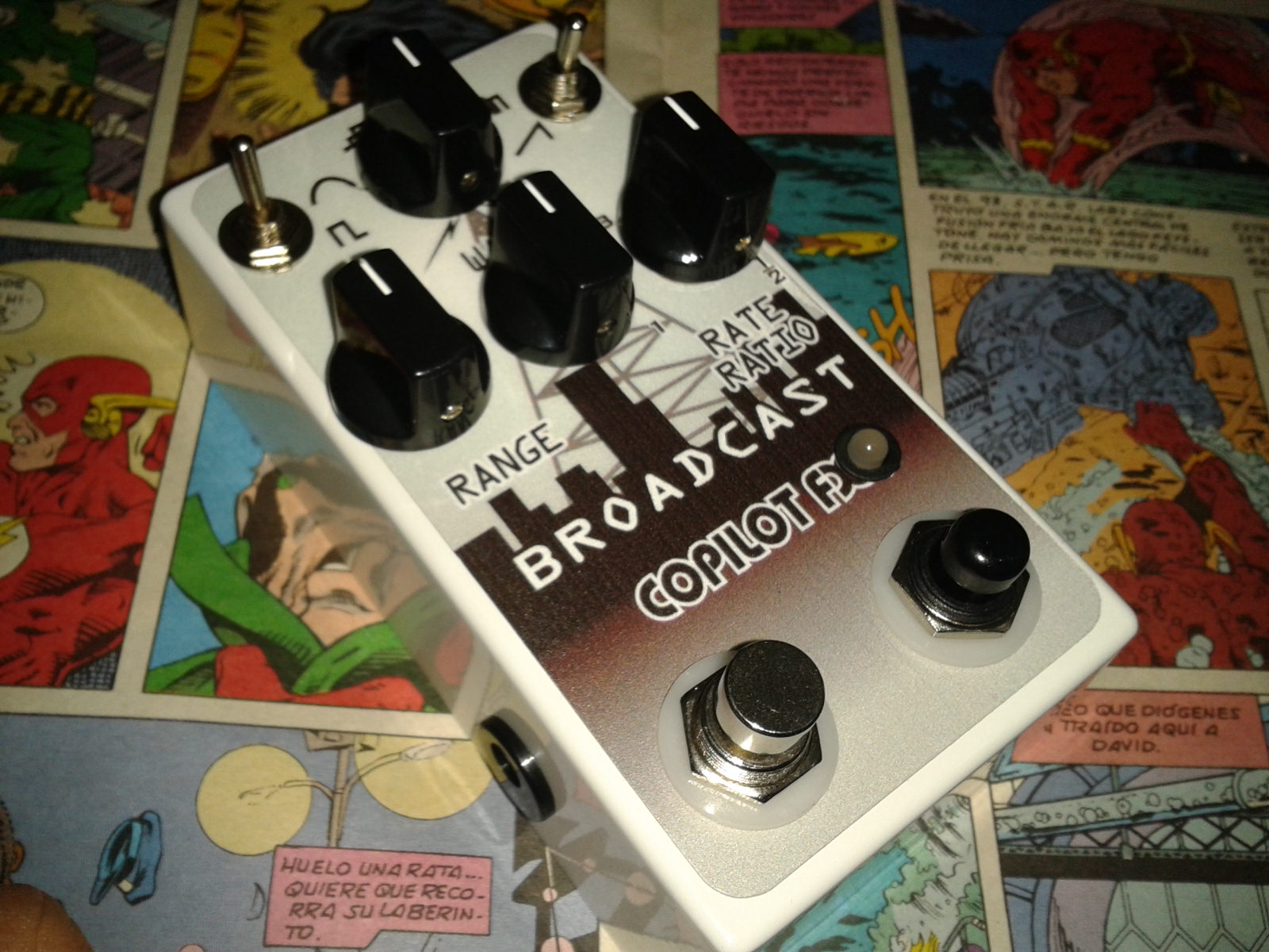

Broadcast with expression option to control the rate/ratio via external expression jack

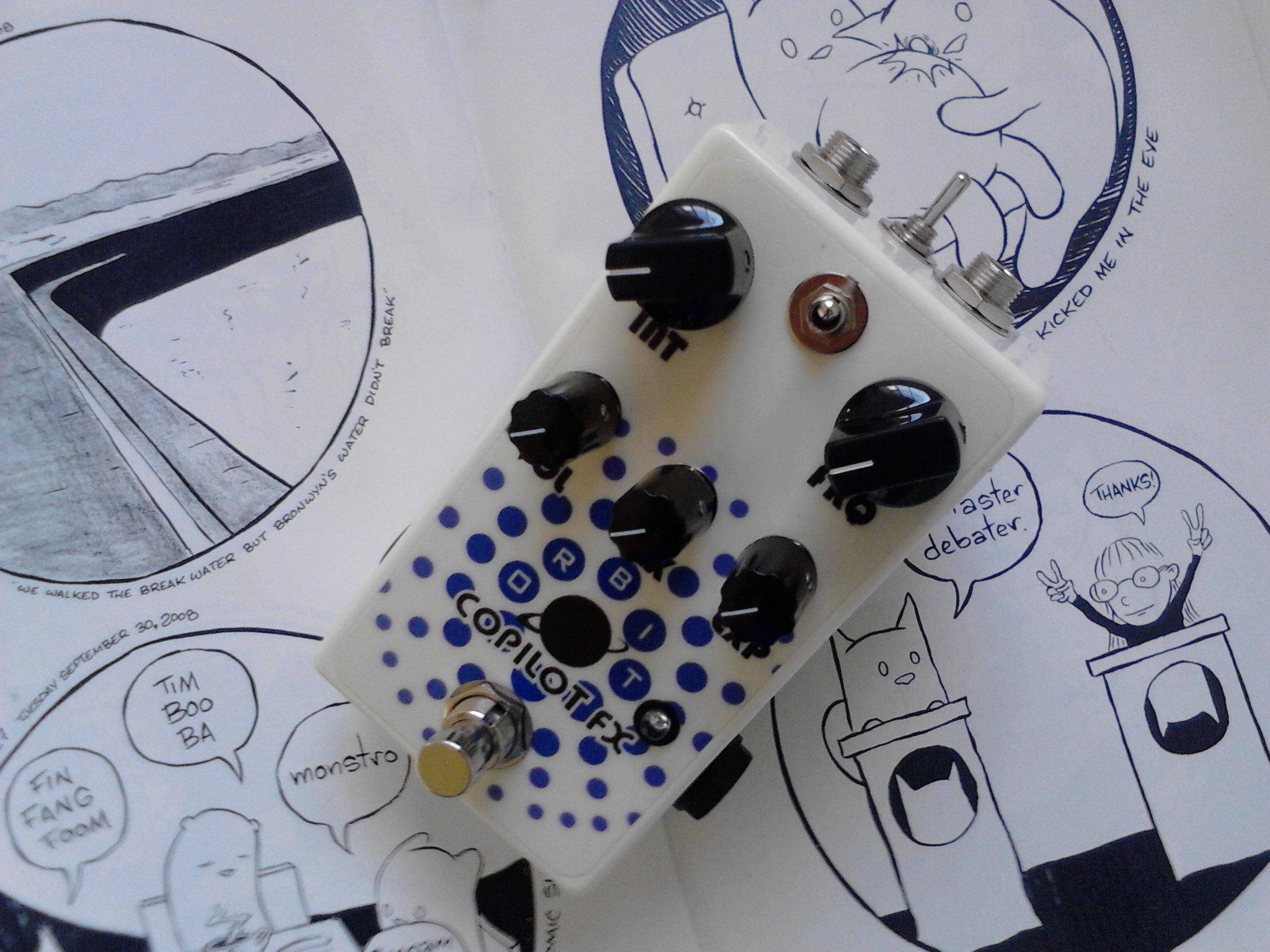

Orbit with some extra flavor, the expression is set to control the mix instead of the freq, there's an extra toggle to also sync the exp (freq fine tune) parameter with the mix (the exp knob is disabled and it is controlled via the mix knob or the expression jack), so you can from full fuzz sound to full vco sound

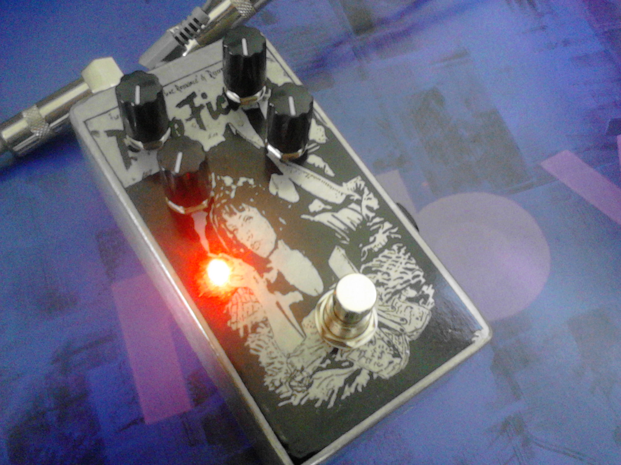

Post by autopilot »
trek with lovely pulp fiction graphics

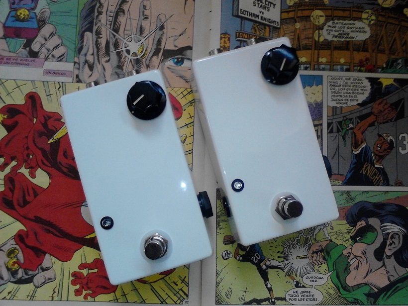

vca's with cv control input

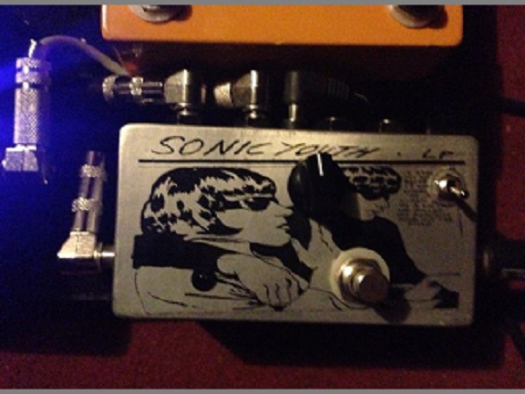

Yeahz, i love the Goo artwork, this is an interesting device, is some sort of Blender, it has 2 loops, one wet loop (which is always on) and a Dry loop (with nothing plugged in works as a clean blender) over the wet loop, a simple wet dry setup solution, great for the shoegazers and people that uses lot of fuzzes at once and need to have some clarity and the layers/processed sounds of running lots of pedals at once. the switch add/kill the dry, with the dry off is just like your regular signal chain. Toggle changes the frequency of the dry, so you can have a full sound or trebbly jangly type of sound going on it, mixed with the wet loop.
