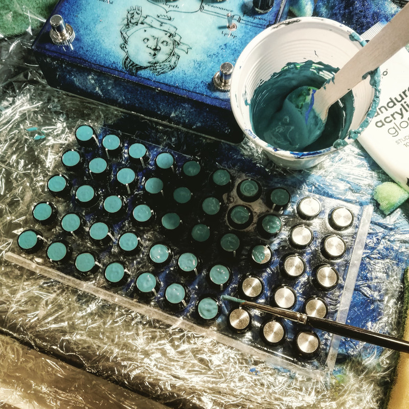

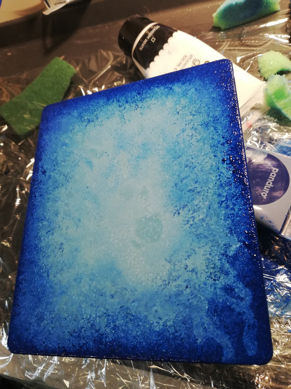

It's been a while. Currently working on the first batch of BioMoons now that I have some time off. Thought I'd share some work in progress shots.
Painting the enclosures
Some clear coating
In da sun
All dried and waiting for the next step
Knobz. These are are real pain in the ass to make, but I really like the look.
Finished product :joy:
I hope you are all well. I will try to update this thread more often over the summer. :group:
