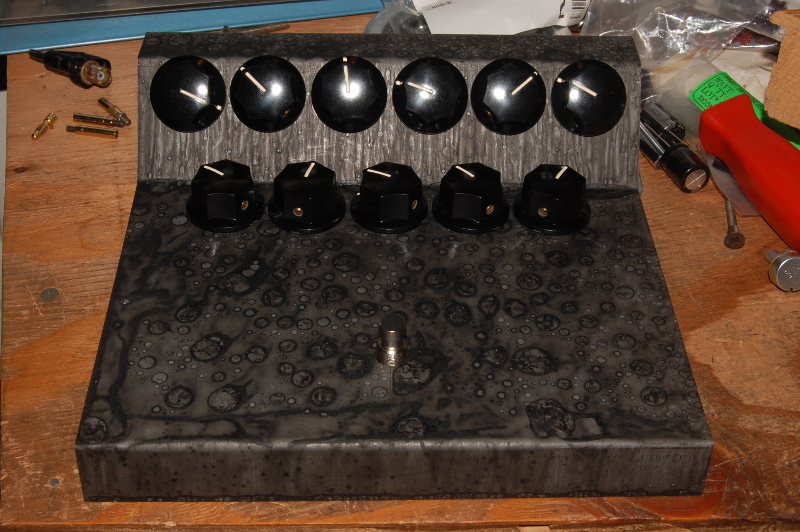

I think I'm zeroing in on the finished look of my build, holding off on mocking up the switches to decide if they'd lend themselves to foot switching or strictly panel set.

beautiful finish. damn.crochambeau wrote:I think I'm zeroing in on the finished look of my build, holding off on mocking up the switches to decide if they'd lend themselves to foot switching or strictly panel set.

Thanks! It improved a little under a coat of clear since that pic. I'm sort of using this project as a concept test bed for aesthetics. It's been really fun so far, and I'm hoping I have the patience to hold off on the big reveal until the electronic side is finally wired up (board is populated, I just haven't done the loom yet). Better hurry though, I've got a scant two weeks left in order to meet the imposed deadline...multi_s wrote:beautiful finish. damn.crochambeau wrote:I think I'm zeroing in on the finished look of my build, holding off on mocking up the switches to decide if they'd lend themselves to foot switching or strictly panel set.
