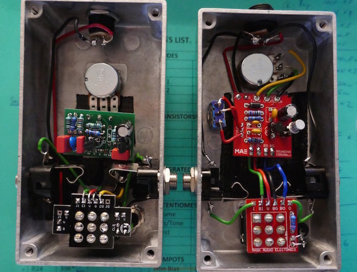

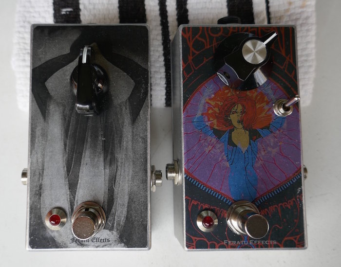

Boxed up 2 more, a Meathead (M-13) Dark on a Fuzzdog PCB and a Rounding Error on a MAE PCB that has been lying around for a while. The switch on that one is for different input caps.

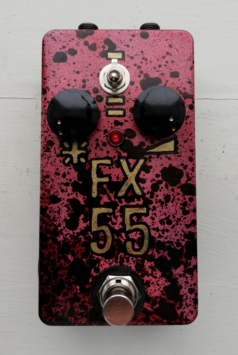

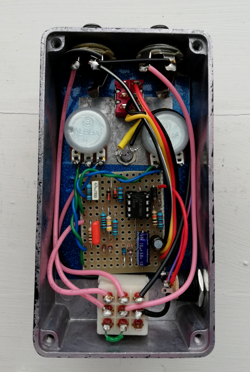

After a long, unproductive winter I managed to box up one of the 10 or so circuits I have lying around. A simple DOD FX55 clone with an additional germanium/BAT46 output clipping option for a more ragged and brighter sound.

Looking good, that FX55.

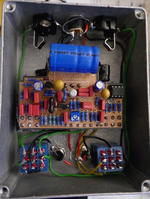

Here's something Dunwich designed: a Bass Boost/OD that doubles as an (power) amp. I've seen a few of them in the wild, but never got around to order one from the master himself before he hung up the soldering iron. Fortunately, Nick was kind enough to hook me up with a PCB, what a great guy!
The bass boost is killer and if used as an amp, it sounds surprisingly good with my old Italian 2x12" from the 70ies that I use at home.

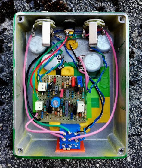

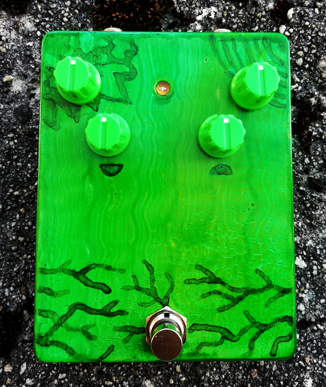

I built the best Muff I've tried so far, a straight clone of the Black Arts LSTR. The mid scoop is what makes it, and the MPSA12s I guess, never came across another circuit that uses those.
The finish was a series of mistakes, from an ugly yellow with a terrible green paint that ate through it, to a white re-coat that crinkled badly.. sand off again and then cover with an eye-molesting green wash. It will do.

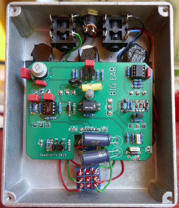

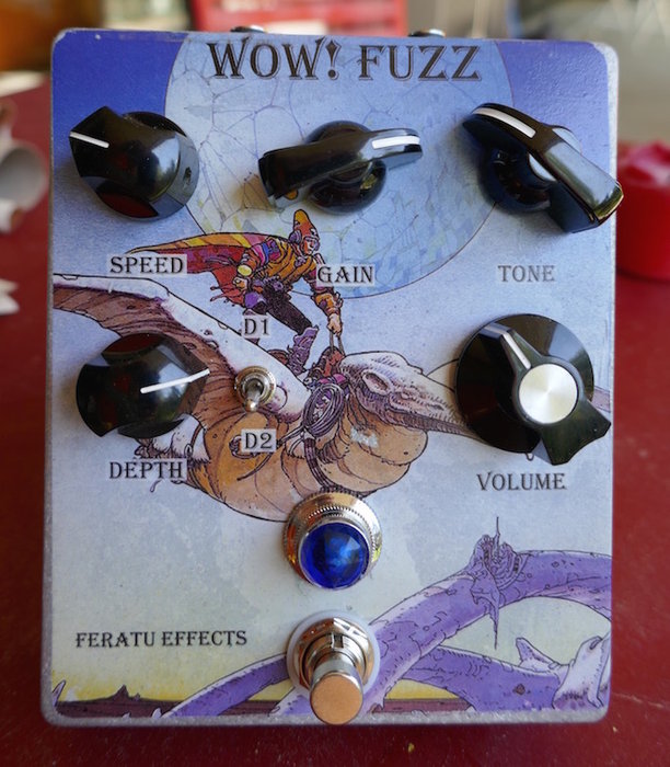

Here's my Big Ear, a Spaceman WOW Signal, PCB from the amazing guys at Deadend FX.
It's up and running, sounding great, but I still need to do some fine tuning.
Q4 and Q5 aren't matched, I just had one of each left and none of them is within the recommended hFe specs (one too low, the other too high). I ordered more of those to see, if I could get a smoother gain.
Then, I need to try other stuff in C8 and R25. Currently, there a 2n poly in C8 and the stock 16k in R25. Thing is, on the more extreme depth setting of the switch, I get a nice stutter effect, when turning up the Depth knob until the signal cuts out completely. That's cool, but it happens to soon on the dial, so that the last third of the turn does nothing. I'm not too sure about all this yet, but I'll see what happens ...
Q6 seems to be fine, I have 5.22v on E. (It's a MP14B though, as my P416As were a bit low on hFe, in the 30ies IIRC, might still swap that too).
Anyway, here it is.
