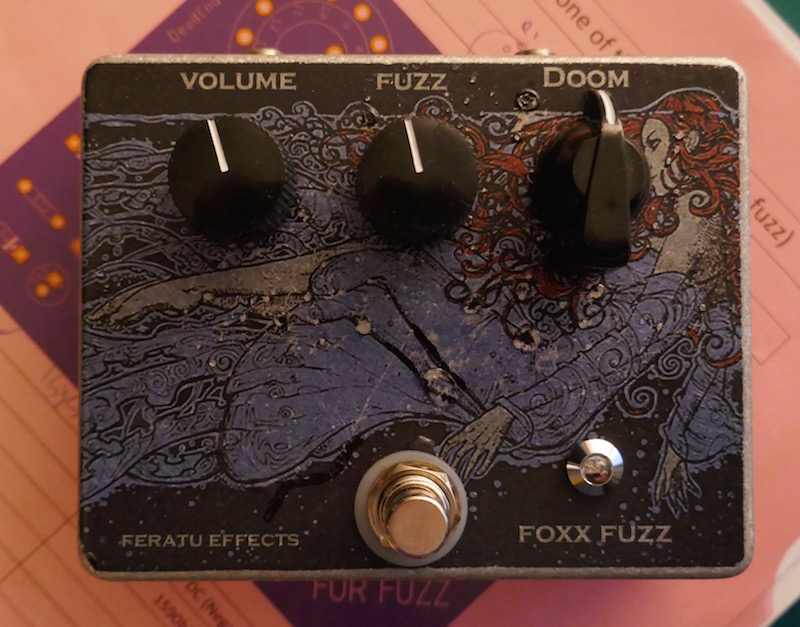

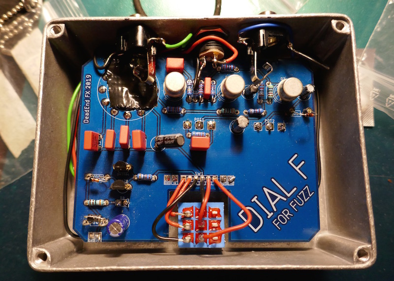

Here's another Deadend PCB, the Foxx Select-a-Fuzz. 5-way rotary for cap selection to give it different types of Doom.

How does that one sound? Going to make another order with them once the Double Sub is released. You see that one? Seems incredible.fuzzonaut wrote:Thanks Frodog.

Sounds great, the cap shifting adds a nice notch each time. And yeah, the Double Sub is crazy, I must try that.LaoWiz wrote:How does that one sound? Going to make another order with them once the Double Sub is released. You see that one? Seems incredible.fuzzonaut wrote:Thanks Frodog.
Nicely done, it's great to see some of our pcbs out in the wild.
I'm chewing over the Double sub release, it was a commission for a guy in the UK to replace a bunch of stuff on his pedal board. There are a few quirks with it like the wet / dry mix is backwards on both effects and an issue with the dry signal being present in bypass when the mixed output is used and only one of the effects are engaged.
This is how the guy asked for it and he is happy, whether or not it works for anyone else is up for debate.

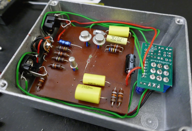

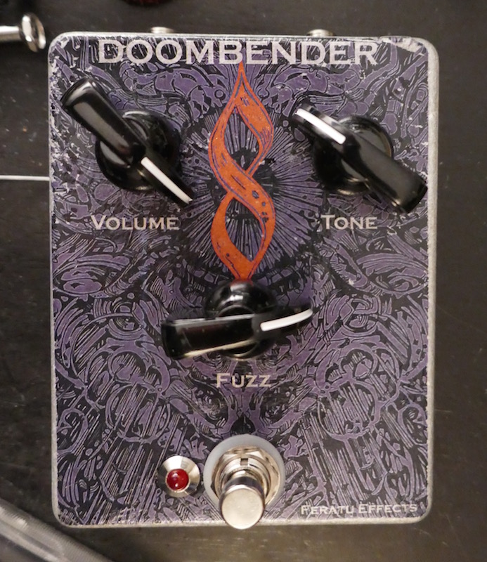

My first time doing something a bit old school: a Tonebender MKIV, on a phenolic PCB, classic layout, resistors, caps, yadda-yadda.
As I like the convenience of a 9V power supply and a pilot light, I used a foot switch PCB to get that.
Sounds really great, not a ton of volume on tap, but enough. I might still check out what jumpering that last resistor will bring.
It's "stock" regarding componenet values, I just wanted to own a pedal called DOOMBENDER ....

That looks ace. I like how the circuit fills out the enclosure rather than just occupying 1/4 of the space. What’s the graphic from?

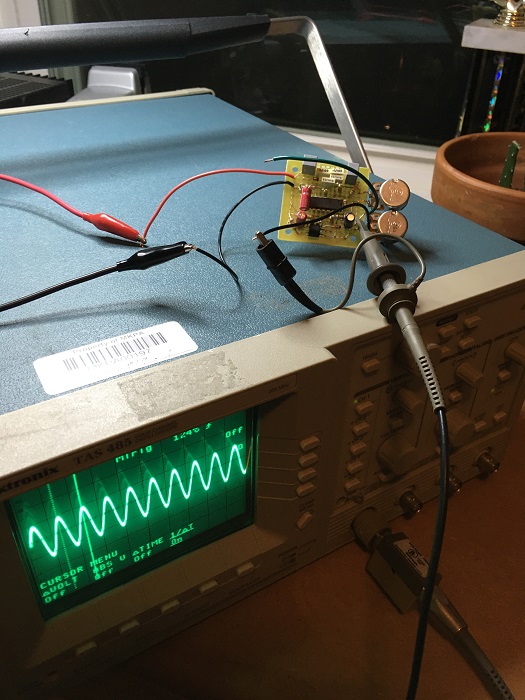

I finally have my workspace setup in my new apartment!
My old oscilloscope had been acting up and not really working lately so I took it apart for a serious cleaning. I am beyond amazed at what a difference re-seating and cleaning every contact, connection, and button has made. It boots up almost instantly now, no more relay freakout, no more ghost signals on the crt, and every feature works. yay! I wish I had done this sooner now...
I also decided to put together a basic sine generator for testing builds. I built it on vero out of spare parts based on the valve wizard Low Cost Sine-wave Generator. It's super simple and stable so I recommend it to anyone who needs a sine generator. I just need to sort out a setup for drilling enclosure in my new place since I sold my drill press when I moved.
