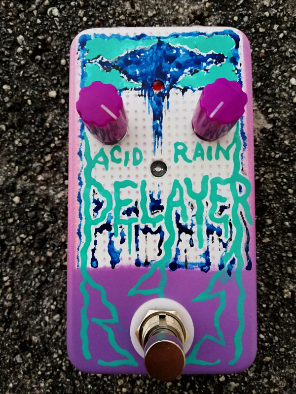

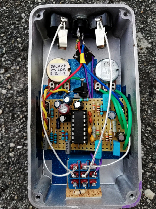

Here's a Rebote delay I built, with an LDR for modulation. Upped some of the cap values and a couple resistors, selected a non-clipping chip+jfet and it sounds really nice, even does a light boost with the fb/mix (acid) off. Rain is the time, it was supposed to be the other way around but still fits, as you turn up the time those rainclouds of noise appear. Below noon it's very passably clean. It does not self-oscillate is the only drawback but I don't really mind.
Oh yeah and this is a delayer, not just a regular delay. As far as I could find nobody had used that name before, or maybe they threw it around the boardroom and thought it sounded stupid, so I'm claiming that :lol: .Every PT2399 thing I make from now on is gonna be something-something DELAYER.
that's a really cool looking build
like the finish
and the name "delayer"
I don't recall seeing that on anything

Thank you. Think I may just have made the first delayer ever!
Of course i jest, anyone is free to use the description of what a delay chip does, but I felt like a real clever boy when I thought of that.

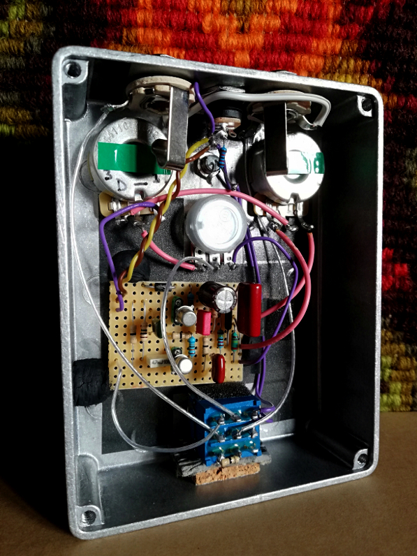

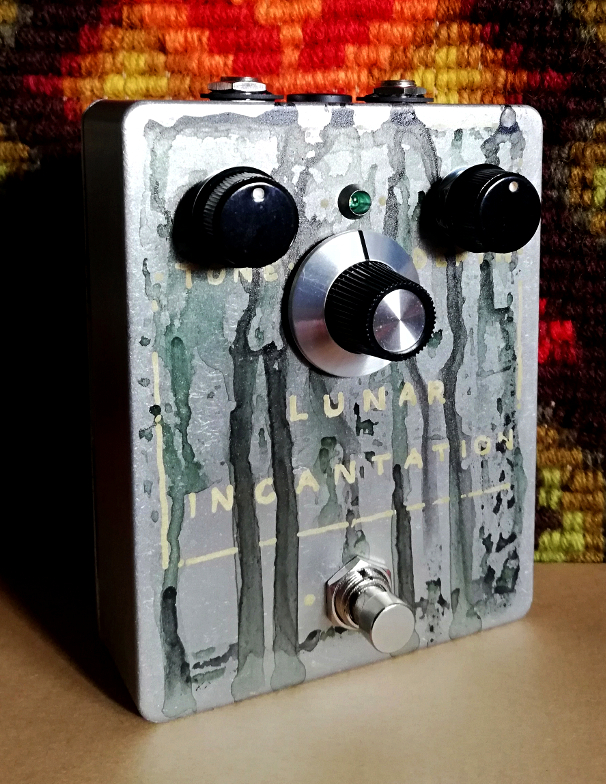

Here's a clone of the Ghost Effects Lunar Incantation. The vero was cut to be a Catalinbread Merkin, but as I was breadboarding that and other Fuzzrite-type circuits, the Lunar Incantation variant won out and it was adapted as such. Went through a bunch of BC108Bs from three different manufacturers until I found a nice pair. Definitely a lot of variation possible, I'd love to someday own a real unit.
Finish is old stock Citadel Color green/armor wash rivers with gold paint pen and matte clearcoat. Two rare NOS knobs (Spooky Tooth anyone?) seemed appropriate.

Citadel washes up in this bitch... bout to get some Grimdark on. Lunar incantation is great. I built one too hehe. Great build dude :)
