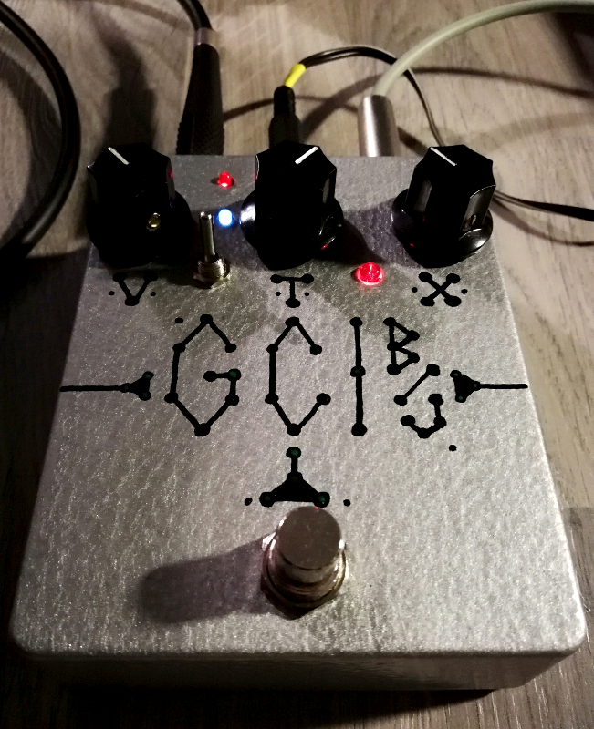

Here's a simple thing to contrast. Not entirely symmetrical graphics, was a paint pen quickie, but hey always possible to build another since I got two from a guy selling these unbuilt PCBs.
I dig it, very metal distortion with scoopy eq, idk never tried a STD1 before. No mods except selectable (visual!) LED/none/Germ clipping.

How does it sound without clipping selected?
Nice artwork btw, love the two asymmetrical LEDs!

Yo, thank you!
With no diode clipping it sounds very similar to the LEDs, a bit less compressed maybe. But I added an 8.2nf cap in parallel with the LEDs, so that setting is slightly darker anyway.

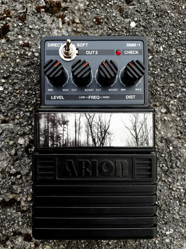

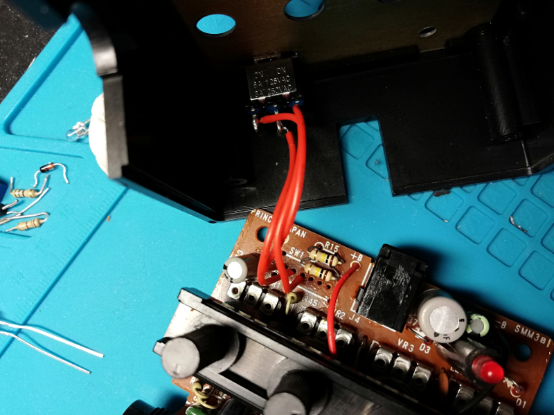

Speaking of switches, I finally got around to replacing the broken one on my Metal Master. More hassle than I had thought, the old tallboy switch was soldered into ten holes (only three active, the rest for support) and the new one came down right on top of the two resistors you see there, so had to pull/reorient them too. But now the second output works again.

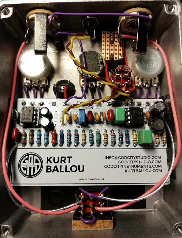

frodog wrote:
I know this may sound weird but... I love gut shots with a variety of component types, colours etc. So much more interesting than the usual lines of blue resistors and yellow box caps or whatever. :)
edit: ok, can't quote with the image, sure you get what I'm on about. ;)

Haha, that is basically why I do it, just want some more color and variety on the board. Plus it makes it easier to see at a glance which value they are than if there's only one or two types of resistor. I doubt it makes any audible difference except for value discrepancies here and there, though I mostly reserve NOS stuff for the audio parts of the circuit.
Yeah this forum doesn't allow you to quote attached images, only externally linked I guess? But there's a workaround - copy image location (before you click Quote), then delete the attachment(s) in the quote and replace with the copied link between [img] tags. :)

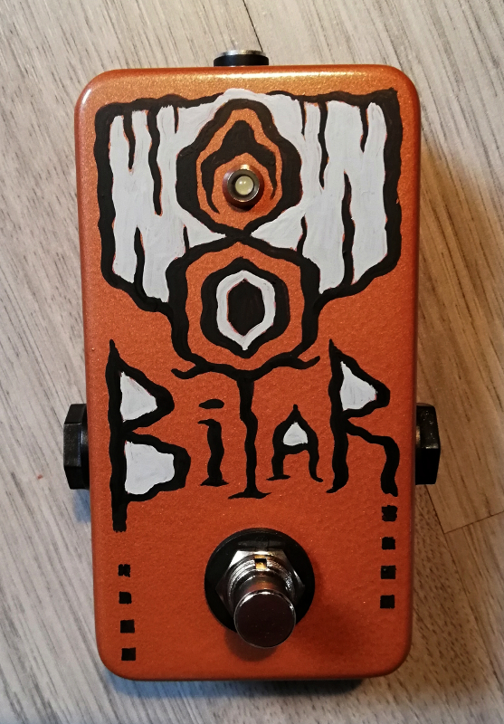

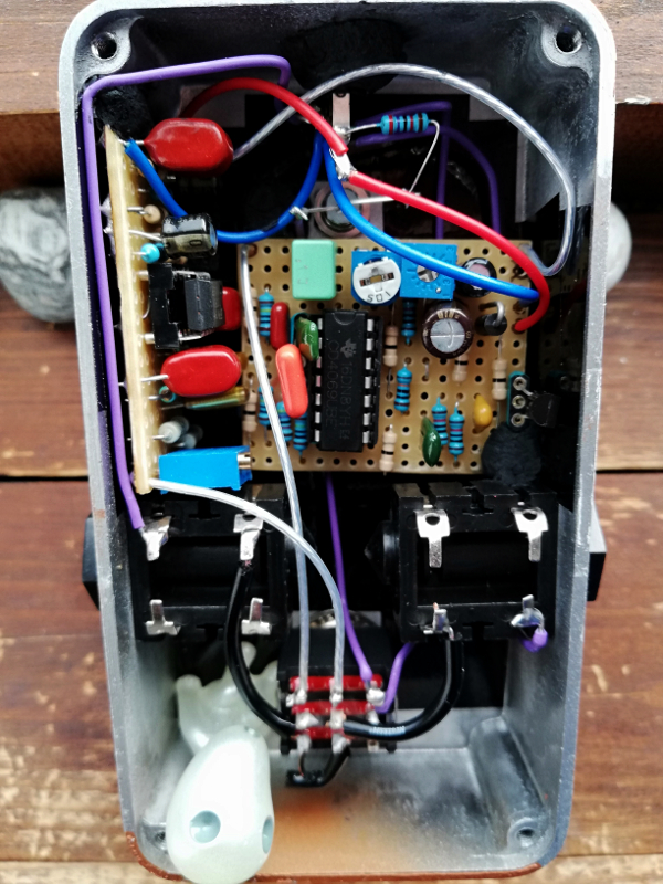

An old Parasit Studio 8 Bitar vero build finally housed. Combined it with this neat Tilt Control EQ (http://guitar-fx-layouts.42897.x6.nabbl ... d8433.html) because I wanted it bassier, and it fit this leftover 8 row piece of stripboard. Turns out that's the height of the side of the enclosure, leaving room for the primary circuit. 22nf caps (centre freq 220Hz), so it's boosting below that/cutting above with an impractical multiturn trimpot.
Oh yeah, all the controls on this are internal - input resistance and output of the 8 BiTaR as well. Another self imposed limitation as I was curious if a no-knob octave down would be useful. Turns out... mehbe? I am still making incremental adjustments, figuring it out. I want to find the balance where it's not too loud or quiet compared to a fuzz or something, and not focused on an unflattering frequency. The tracking is pretty solid right now, of course glitchy in a cool way, and it has lots of low end but also enough highs.

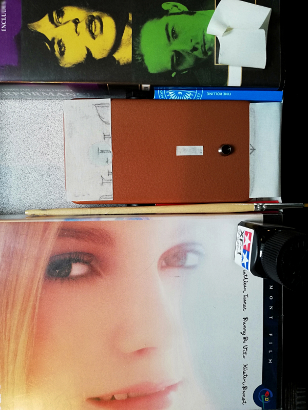

Painted once again to resemble a rural metal band's demo tape from the early '90s. Or, just cause it's better to embrace the squiggle than stressing about straight lines and shit. That being said, here's my jig to make the process easier; two VHS cases (empty or loaded) taped together around the edges, for holding the enclosure and wrist support. Then you can also tape that onto a piece of cardboard or heck, a VCR, for extra holding power. Video tape is not dead!

As a note, this one did not play well with some of my pedals. It was so stupid in fact, it made the Warped Vinyl cry and the Accountant have a serious volume drop. After a while I found the culprit to be the TL072 in the Tilt Control. I don't know why but suspect it was buffering the shit out of the signal, so even though it didn't sound super loud other pedals didn't like it? The fix was replacing the TL072 with an LM1458, that normalized everything. It remains to try with a real bass amp, but for now I'm happy enough with it that I'll leave the trimpots as they are.
