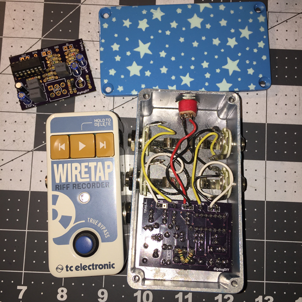

couple things recently
1a. swapped the "stomp" switch on this TC wire tap i just got. i had heard about the crummy switches TC uses
but i could still not believe that they think what they have is good enough to stomp on repeatedly.
its not even a stomp. its a tact switch...wtf!? its laughable. i honestly LOL'ed
1b. an active add trails to anything fx loop pedal & board i made. prolly not the most efficient way to do it but it does it!
was inspired by a thread on here a couple months(?) back where someone used like a boss pedal and a y cable.

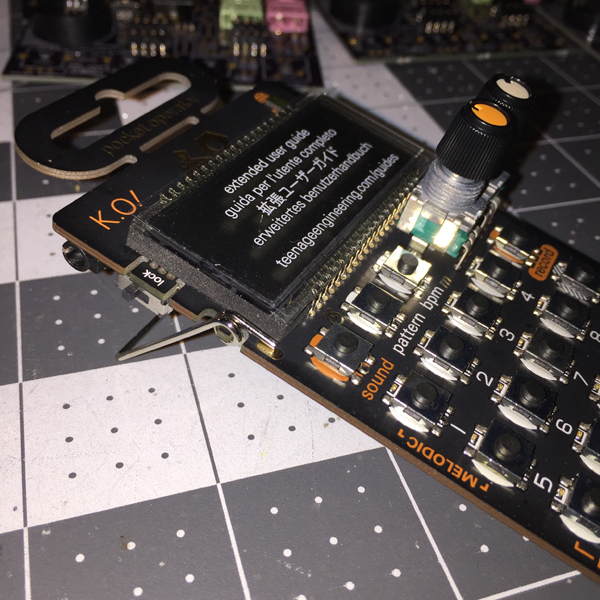

2. i've done a couple of these already but did another one. PO33 KO! modded with better (not jumpy!) pots and a lock switch on the side
mini knobs are for a roland boutique tr08 (i purchased extra knobs from roland's parts department awhile back)

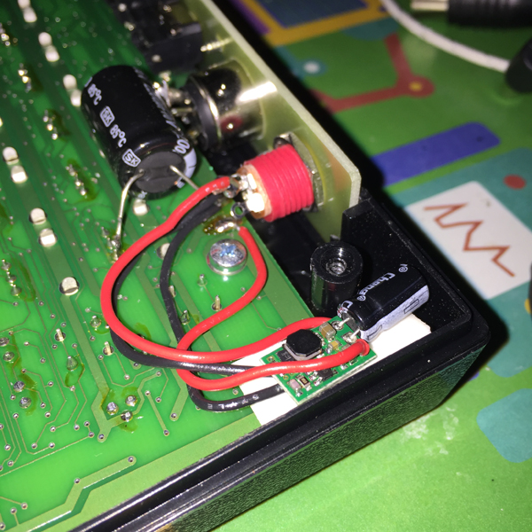

3. modded my MFB 522 which is like an analog mini 808ish clone.
changed the power jack, flipped the polarity to center negative and added a step up voltage regulator so it can be powered from anything below 12V.
USB battery! or just a onespot or something. might try to put a LIPO battery in it for fun but i didn't have the battery charger board at the time.
