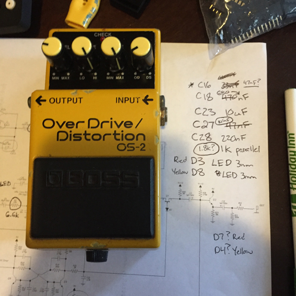

by Dr. Sherman Sticks M.D.
2018-09-25 12.17.28.jpg (270.92 KiB) Viewed 5552 times
another mod i did this morning.
the OS2 was the first pedal i ever bought when i was in high school
they are super cheap now so i figured why not bask in nostalgia a bit
well stock, it sounds like someone threw a blanket over the amp :(
so i decided to mod it a lil bit & now it really cooks :hello:

Posted: Tue Sep 25, 2018 3:57 pm
by BetterOffShred
What sizes did you use for the input cap toggle? I think I put a 4.7n that measured 5n in mine and then a 47n on one side and a 15n on the other. I l ikr the 50+n stacked with my unidrive clone.. pretty huge
Posted: Wed Sep 26, 2018 5:19 am
by Ben79
I used 4.7n for stock, 22n for mid and 100n for full. I had been using 47n for mid but I could barely hear a difference between that and 100n so 22n got me the halfway point I was looking for. I like the circuit a lot for it's simplicity but also the breadth of tones available just with input cap, output volume and pickup selection. I was running it into a single ended el84 amp that overdrives easily so with full range boost it gets really dirty and squishy.

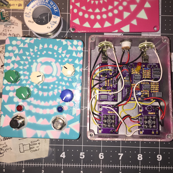

Posted: Sun Sep 30, 2018 4:12 pm
2018-09-30 15.41.24.jpg (426.32 KiB) Viewed 5438 times
feel like i've been posting a lot in here, hope i'm not burning y'all out
but speaking of boosts...finished these up this morning and noodled w/ it while baking some homemade pizza.
dirty boost/low-gain overdrive into a colorsound bass fuzz-ish, which to my knowledge is pretty much just a tonebender w/ bigger input caps..?
