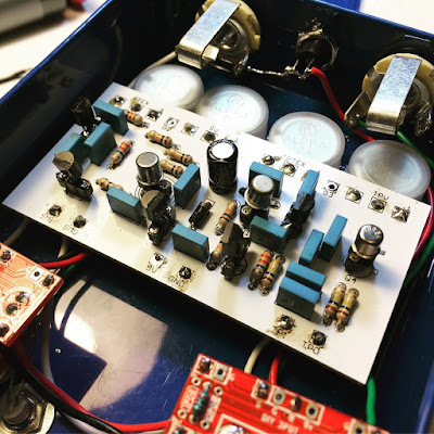

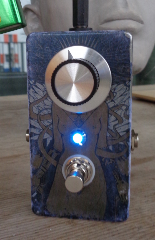

Hunter Fuzz. (Devi Shoegazer Work a like) PCB layout by me. Etched Face plate by me as well. enjoy
Hope you like it!

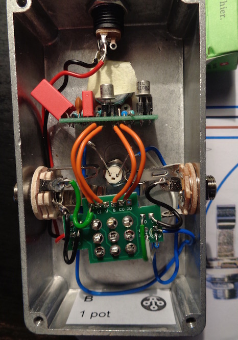

I'm still doing easy stuff and just finished one of the 1-knob fuzzes from Fuzzdog, the 66BALLS. Sounds great, pretty aggressive and has lots of volume on tab.
It's supposed to have a BC108 (Q2) and a BC109 (Q1) - I used a BC108C and a BC109B (or C ? - I already forgot). I didn't find them without B or C ... :idk:
Both are in sockets though, so I could swap them.

The B and C designations are for gain ranges. The Cs are the higher gain of the two, and you can swap in 549's and 550's and 548's which are the end of life replacements for 109s and 108s. It's worth auditioning the various gain ranges there imo. The 550 is the low noise variety. They are cheap AF and have fantastic gain, up to 800 if memory serves. I have bags of them :thumb:

Thanks for the nice words and the clarification. I just checked if Musikding has the 550's - and yep they do have the C's, gain range from 420 up to 800 (good memory there :thumb: !).
