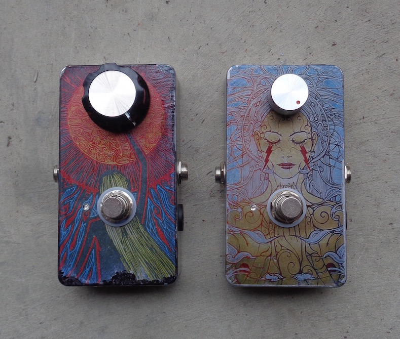

Absolute beginner here, on the left, my very first build, a Bazz Fuzz (Fuzzdog kit), that worked right away.
Then I got excited and tried to build a ColorTone Bass Fuzz next, which of course isn't working .... :facepalm:
Tired of trouble shooting, I decided to go back to 1-knob fuzzes and built another Bazz Fuzz, the one on the right, this time using a different diode and socketing the transistor.
Next up is a Dark Grime, then I'll try a Mojo Dust. After that I might go back to trouble shoot that damned ColorTone ... :mad:

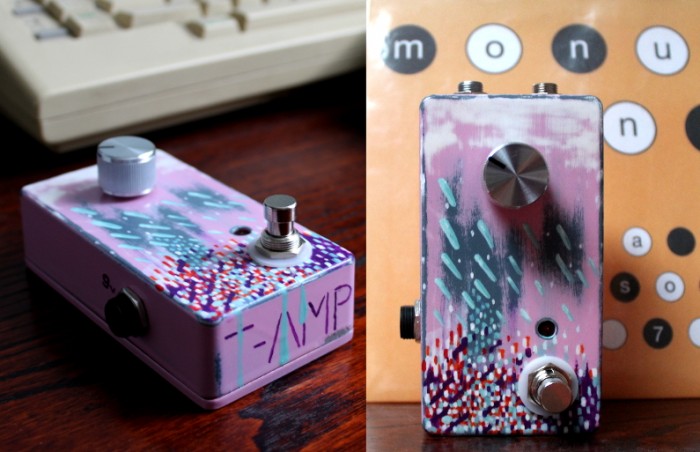

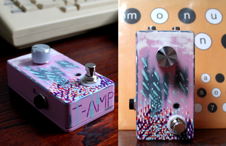

First finished pedal y'all. T-Amp PCB from Mask Audio Electronics. An easy build which I did in parallel with three other circuits (yet-to-be-boxed). Of course the enclosure was the most time-consuming. I drilled, sanded and washed it, then sprayed it with a grey base coat, then pink (sanded), then painted it with various model paints I had lying around, and finished it with like 5-6 coats of clearcoat.

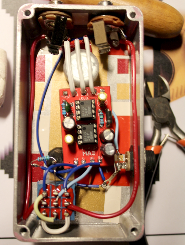

The inside looks a bit rough but everything works. Had to mount the short-legged pot above the PCB with some solid copper phone wire. Fitting the LED was among the more difficult things, it's a big one and wouldn't fit under the circuit board as I had hoped (guess I could have mounted it sideways). I used one of those transparent round LEGO "lights" as a bezel (need to lacquer the top, that sunken hole is gonna collect dirt) and Sugru mouldable glue holds it in place. Floating 5.6k resistor for extra dimness.
Oh, and it sounds great! Can't wait to box up the SFD next (also from MAE).
