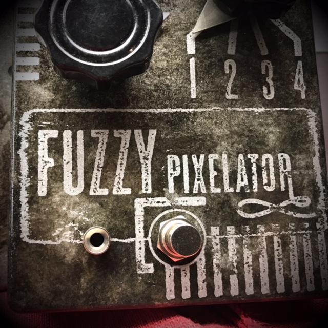

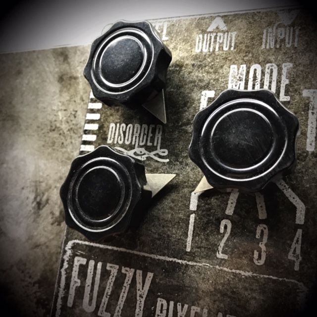

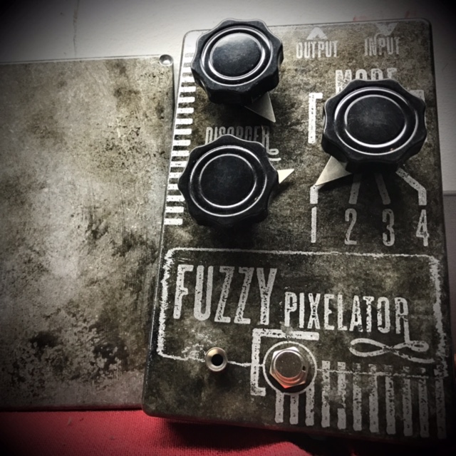

After much tribulation, this one is finally boxed and done. The board layout (done by pickdropper) has long been verified, but I wanted to try out some new finishing techniques. I used rattle-can auto touch-up paint (4 coats), then laser-etched the artwork, then filled in with Sharpie (yes, Sharpie), and finally clear coat on top. It worked, but this particular example isn't perfect; it's not even all that pretty. But I'm proud of it because it was a lot of work and I learned a lot in the process.
Also, I thought I had the pots on hand, but didn't. Then I ordered, but ordered the wrong kind. So it's taken me a couple weeks to finish the build.
So yeah, it's kinda ugly. Also, the guts are far from tidy, and I badly mis-drilled the I/O/Power jacks. It's a case study in why you shouldn't just eyeball the drilling, especially with no center punching or pilot hole.
I'd never in a million years sell anyone something this ugly, but this one was always intended for me, so I'm fine with the final product. It sturdy and works well. Good enough for rock n roll, especially when I'm headlining Madison Square Bedroom.

I'll just say for posterity that all of my pedals are much uglier and I've built like 50 or so and none of them are that neat. I applaud your presentation. I mean that. It gives dudes like me something to aspire to with the craft.

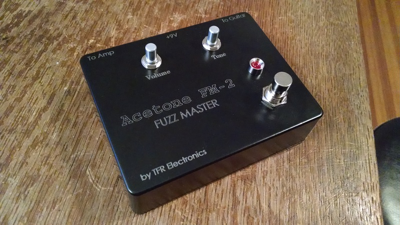

finished up one of my PCBs and put it into an enclosure! I used a laser marker/etcher we have a work to do the text.

NICE!imJonWain wrote:finished up one of my PCBs and put it into an enclosure! I used a laser marker/etcher we have a work to do the text.
