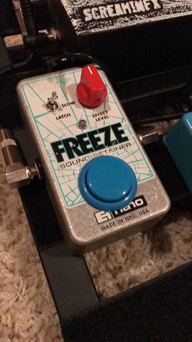

But this was pretty cool. I really like the arcade button in the freeze. I'm not sure that I would like it on a B3k, for example, but it fits well here.

I was just looking at a bunch of those buttons on Adafruit after looking at the bananana pedals, you don't feel like it's a little fragile?

Arcade buttons are built to take a beating. You can abuse them pretty hard. The actual mechanism is super simple too, and if for whatever reason it breaks, it's really easy to replace it with a new one.

It's plastic, but the actual switch can go lower than the outer housing so you'd need to literally shank it in order to break it

Oh cool, so if I stood on it like an asshole it would be fine. That's actually exactly what I was worried about haha

Yeah, I built a MIDI keyboard using arcade buttons I play (clumsily) with my feet which I've posted on here before. The buttons are by far the part I'm least likely to break. My neck, however...

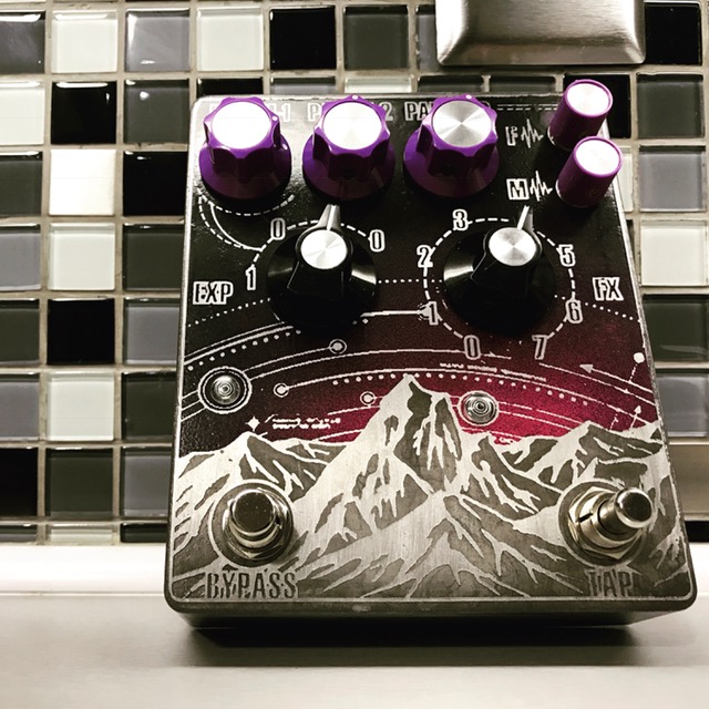

Made this with Mike (flanagan0718 on here, who did the wiring).

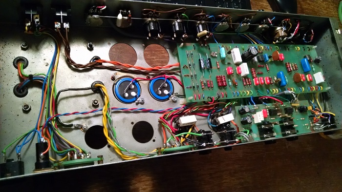

Cleaned up the wiring inside my Laney AOR a bit, they are kind of a rats nest from the factory. I was surprised how much quieter the amp is now too, it always had a mild but audible constant hum with all the volumes off and now you have to be basically against the speaker to hear it. I also changed the reverb drive and recovery circuits a little bit so I get more of a fendery verb and less hiss but the tank still picks up wicked transformer hum unless I move it a foot or so away....Gotta figure out a plan for that still... I'm also thinking of adding a switch to bypass the effects loop/reverb section (the combos have a buffered effects loop unlike the heads and I ran it without the loop while I was doing the work and really liked the sound, it sounded more "open" and louder to me).
