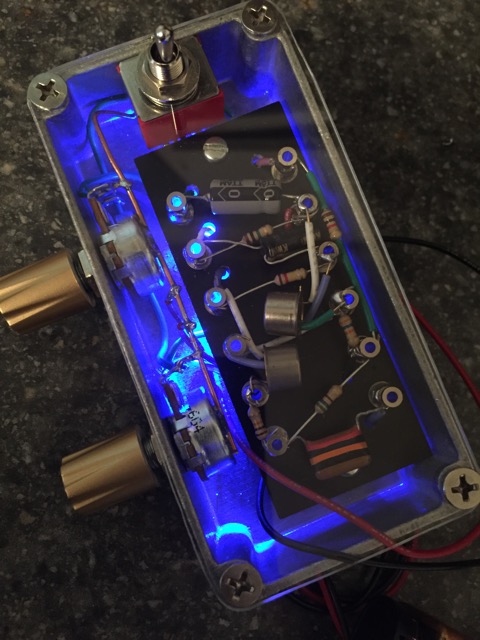

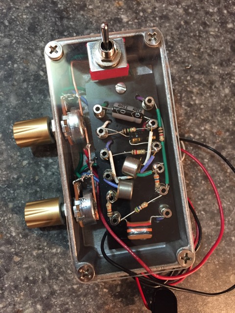

Just finished wiring up a fuzz face for my brother for Christmas. He's in the process of steampunking a Yamaha start copy and wanted a fuzz to mount onto the body.
- Attachments
- IMG_7045.JPG (99.33 KiB) Viewed 6410 times
- IMG_7044.JPG (133.35 KiB) Viewed 6410 times

Seeing the guts all lit up like that is dope

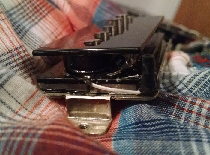

I took a SD phatcat I had and turned it into a quasi EGC/TB style pickup. I removed the bar magnets underneath, drilled out the pole piece holes and put in some alinco5 rod magnets from an old telecaster neck pickup i had. Then I machined a steel plate to fit under neath and around the magnets. I like it so far, sounds like a fat bright loud single coil haha.

This is amazing

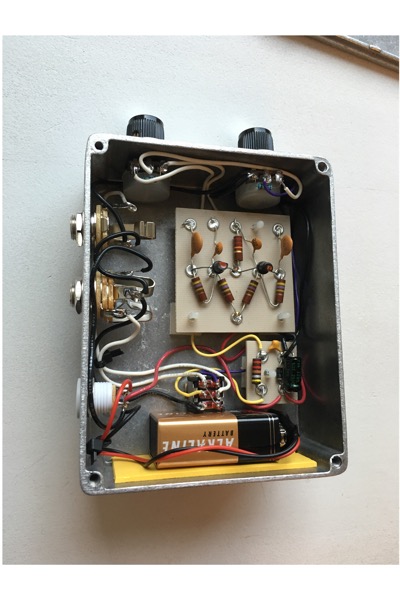

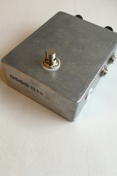

Fuzzrite on eyelet. 2n2926 transistors and a little power/rf filter board.
- Attachments
- IMG_1148.JPG (53.26 KiB) Viewed 6171 times
- IMG_1147.JPG (69.78 KiB) Viewed 6171 times
