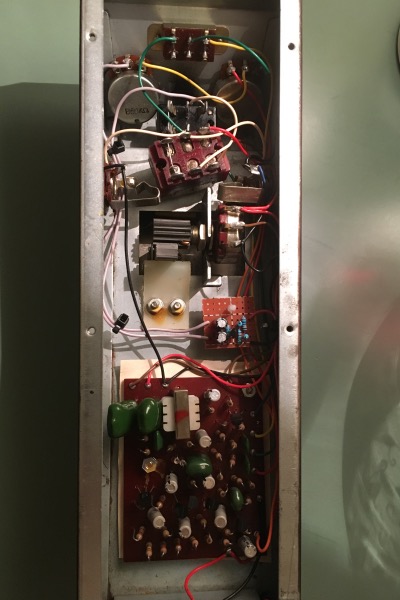

6tr fuzz wah, add the output gain stage from 8tr circuit- the little board above main pcb. This fixes low fuzz volume, respecting Shin Ei design element.

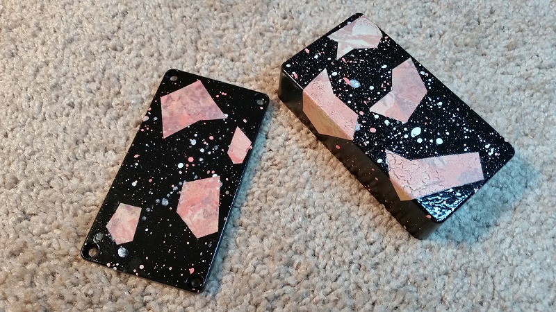

Couple of different tries at spray paint methods.
First one had multiple layers painted and removed with newspaper underneath then had cut pieces of painter's tape placed over it then black with flecks of paint. Sadly, I forgot to sand the enclosure and the paint ripped off when I taped it to drill.

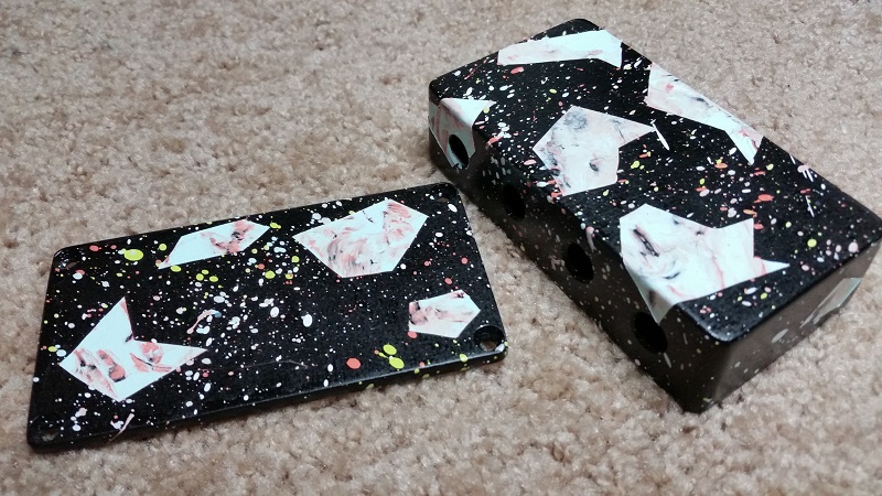

So, I redid the process but backwards.
Black underlayer with flecks then wrapped in painter's tape and sprayed with layers that were removed with newspaper. It ended up a little tacky feeling, but I'm not sure if that's because of the paint or the adhesive.

jrfox92, those are gorgeous.
