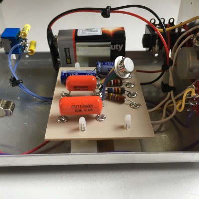

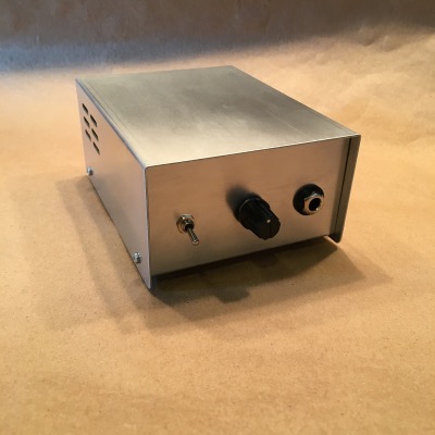

Sits on amp top and makes it sound like old stuff (Rangemaster). Screened many vintage germaniums before settling on a Russian GT308B. Yellow caps on switch allow full, low, or treble boost.

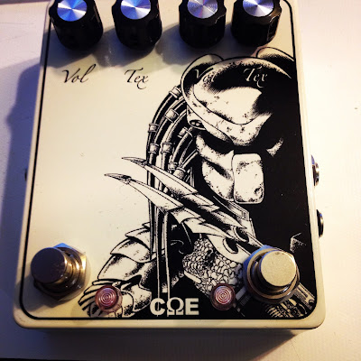

Finished a couple last night.
Shoegazer clone
Deadaustronaut Tremshifter
Hope you guys like them!

It does look like his style. What's the deal with the predator art though? It also looks great, and like the art in your avatar?

Those were both me. Same pedal (shoegazer work alike) for different people. The graphic is a water slide decal with clear coat. They were prototypes I did for the PCB layout that i designed. Thanks for the kind words, check out my blog ( in my signature). Thanks again!

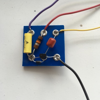

Bazz fuss to keep up the eyelet board chops. 1n456 & MPSA13, Garolite fr4 board.

Nice! These blue eyelet boards are very good looking, where do you find them?
