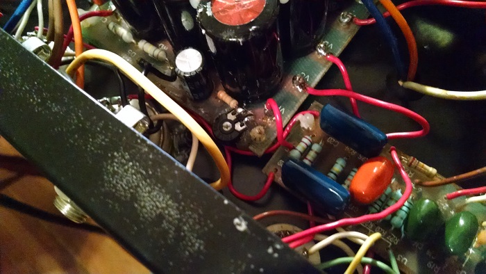

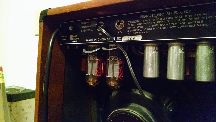

Not as pretty as all the pedals but I have a pignose g40v I've done a bunch of circuit mods too and today just added a bias pot and replaced the 6l6s with a pair of JJ 6v6S. Really liking them so far, I also think it'll help take some of the strain off the PT with the lower heater current.

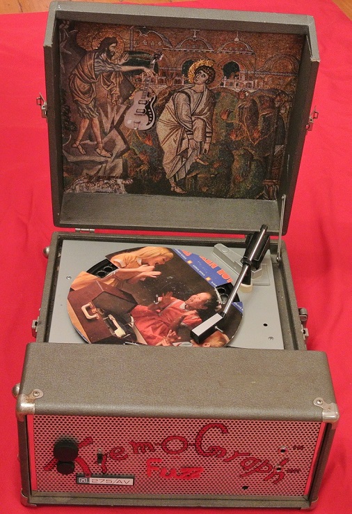

DIY multi-effects unit. Tremolo and Fuzz.
[youtube]http://www.youtube.com/watch?v=fEIOU4FsPIU[/youtube]
gnomethrone
Posts: 1808
Post by gnomethrone »
incredible, professor tortoise

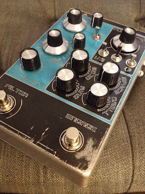

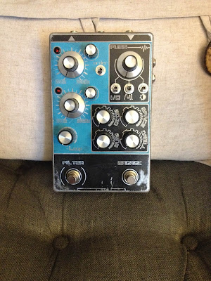

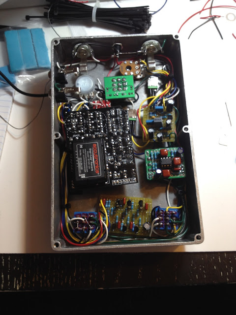

DBA Sound Saw (work-a-like) -> DBA Harmonic Transformer (work-a-like) -> Order Switch<-> Madbeans Moodring -> Blend / FX loop
ENJOY THE MADNESS!!!
-Mike-
My name is Mike and i sometimes build pedals under Custohmelectronics
Blog- http://custohmelectronics.blogspot.com/
Facebook- https://www.facebook.com/custohmelectronics/?ref=hl
Posts: 42267
:love: That's cray! :!!!:

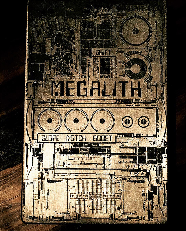

Been a long time! I think it's been a year since I've made a pedal. This half counts as I am rehousing my diy megalith. Now to etch and paint and drill holes and populate. I miss this shit....
