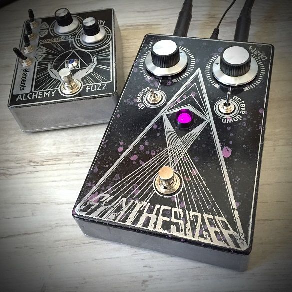

dminner
- Posts: 1102
- Joined: Fri Jan 09, 2015 2:11 pm
Cloudscapes, your stuff always looks so amazing.
Here are a coupled finished projects I just go back last week:
And here are a couple recent enclosures I finished that need loading:
My pedals: https://www.instagram.com/addpedals/?hl=en
- Dandolin
- Posts: 11125
[quote="dminner"]Cloudscapes, your stuff always looks so amazing.[/url]
Yazzzz.
And dminner--your zstuff is looking even better than your usual, if possible--love what you did with dat Synthesizer especially.
Yazzzz.
dminner
- Posts: 1102
Thanks man! Yeah, a lot of people really seem to like the synth enclosure. I actually posted on my FB page the other day that I plan to make a batch of those enclosures for DIY-ers if I can find 5 people that want one. It houses the parasit studio guitar synth circuitDandolin wrote:dminner wrote:Cloudscapes, your stuff always looks so amazing.[/url]
Yazzzz.![]()
And dminner--your zstuff is looking even better than your usual, if possible--love what you did with dat Synthesizer especially.![]()
