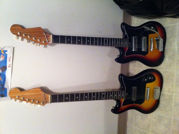

So much jazzmaster on this board! LOVE IT
here are my twangers:
the super gnarly 60s tokais
