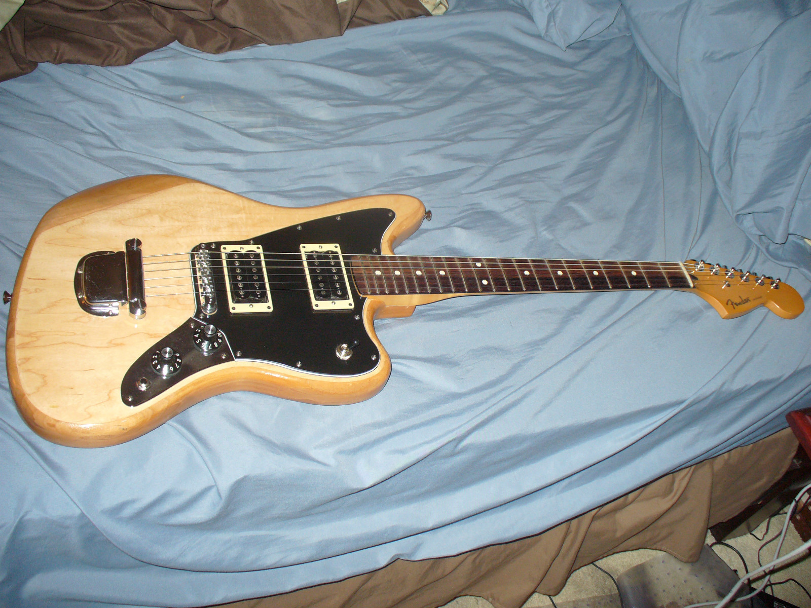

Gonna look like the attachment except with the stock pickups, me think, unless I stain it dark or darker to match my Verellen.... like this:
Which is total awesome and totally what Imma do

Jeez man
That's gonna be awesome.
A blowdryer may work with the finish, but I dunno...I think it'd have to be REALLY hot. When I was refinishing my bass, it still took a while to get the paint well done with a heat gun on the high(1000 F) setting. Definitely safer and neater than trying chemical strippers though. You can do the rounded parts of the body with the scraper if you're careful, but the stuff around the neck pocket is pretty much all sandpaper.
Also, you should stock up on sandpaper types and get some 80-grit or something, because under the paint lies an unholy bombproof shield of sealer. Don't let it see you cry, it feeds on the souls of all who try to sand it.
Just fuck it up with super rough paper, don't be afraid to mess up the wood because it's gonna take a while to break through anyway.
