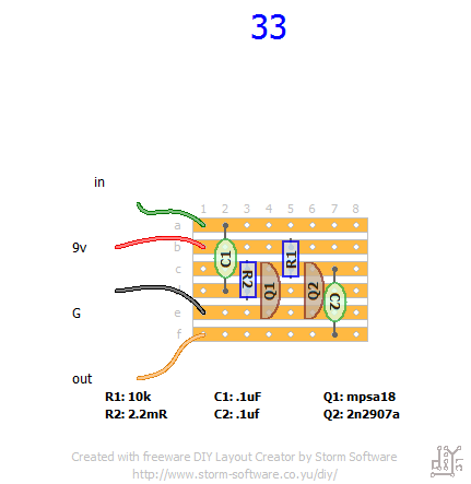

Toonster wrote:I am interested in this, but I don't have perf laying around, I still have more than enough Vero, is there somewhere on the internet a vero-layout?
here is one i just finished making in real life

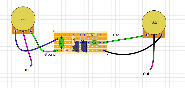

Yur transistors are backwards. And it is missing a resistor.
Here's another, think its right, but I'm an idiot. Didn't bother with proper naming or values, should be easy to figure out.

yup, trannys are backwards. so uh, if anyone uses my thing, don't forget to flip em

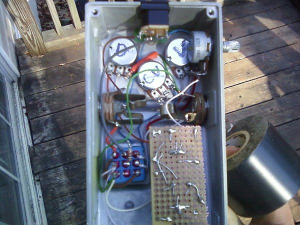

thanks alot for the info in this thread. ive bread boarded a couple of different circuits, but until now had not actually completed a build. finished this earlier today, that yellow box never sounded so good.
was worried i burnt the transisters since i didnt use sockets, but everything turned out ok. solder job def aint the purtiest. but hey its my first box.
dark boost w/ sag & clean vol blend.
