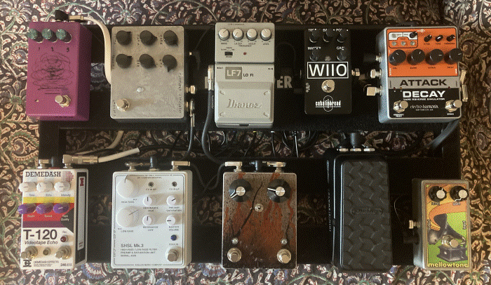

i got everything sorted and wired on the FEB and started dialing it in yesterday. i'm generally happy with how things are working. i had to reconfigure the Attack Decay in order for everything in its effects loop to show up in the signal chain when it's bypassed, but it's working well now. i was considering adding the Instant Lo-Fi Junky for more flavors of modulation and subtle, smeary dirt, but i don't really like the compressor function and you can't dial it 100% out...it still gobbles up my low notes. and i think i have a sufficient variety of fidelity-distressing options between the WIIO, LF7, Virus, and the SHSL's Moogerfooger preamp. i like that the auxiliary boards actually have room enough to step on a box without having to be careful not to hit anything else.
FEB 6-6-24.gif (204.64 KiB) Viewed 5000 times
Posts: 14989
even the color scheme works.
Posts: 14989
oh, heck, signal path: Mellowtone "party favor" Hi Five clean boost (for balancing pickup output levels)->EHX Attack Decay->Attack Decay effects Send->Catalinbread WIIO reissue (Hiwatt-style amp overdrive)->Ibanez LF7 Lo Fi->Stomping Stones Virus->Analog Music Company So High So Low high-/low-pass filter->Fairfield Circuitry Shallow Water modulation thingy->Attack Decay effects Return->AD volume envelope if active->AD out->Demedash Effects T-120 delay v1->Farm Pedals Expanding Universe reverb.
the only things that stuck from the original layout from what, a year and a half ago? are the Attack Decay, LF7, and Shallow Water. everything else got supplanted by other devices that did that job better. even the expression pedal is different.
i was a sceptic regarding flat-plug cables and still don't love their lack of repairability, but they sure as shit made the board layout easier. the Attack Decay used to require an entire inch of additional lateral space to accommodate all six of those 90° barrel plugs, and it was tough to run three on a side between the Pedaltrain slats.
i absolutely love every box on this board. i can't even decide which one is coolest. the reverb is pretty arbitrary, but also pretty unique. the SHSL is an incredibly power signal mutilator in a pedal-sized footprint, the Shallow Water does a lot more than is always apparent in demos, and the WIIO reissue really does act like a large British amp. fuckin' Howard was a genius.

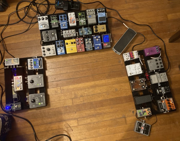

having spent a few days getting lost in the FEB, i decided it was time to get the whole setup going so i got all 3 boards out, wired them up, and set up the amp stack with the Hammond guitar head and Ampeg bass head. i have stored loops on all 3 loopers, so i spent some time last night running them in and out of each other, running them backwards and at half speed, and enjoying the variations inherent in running 3 loops of different lengths while dialing in the amp response. i have everything set up including the bass box, which i'm running off a 2-plug daisy chain that came with the Voodoo Lab power supply and is perfect for running that sort of thing alongside the board; this would also be a good solution for an off-board tuner or a wah-wah pedal. it goes from the PS to the Hi Five, which assumedly has the lowest current draw of anything on the FEB and thus has 250 mA to split with the Octave Multiplexer. i had to do this because the OM refuses to run off a 9V battery. way to be ecological, dumb piece of equipment!
i'm so fucking big.
i'm so fucking big.
full setup 6-9-24.jpg (117.46 KiB) Viewed 4903 times
signal path:
(EHX Octave Multiplexer)->Mellowtone Hi Five clean boost->EHX Attack Decay w/Dunlop mini volume/expression pedal (used as EP)->Attack Decay effects loop SEND->Catalinbread WIIO v.3->Ibanez LF& Lo Fi->Stomping Stones Virus->Analog Music Co. So High So Low high-pass/low-pass filter->Fairfield Circuitry Shallow Water modulator->Attack Decay effects loop RETURN->AD envelopes if engaged->Demedash T-120 videotape delay->Farm Pedals Expanding Universe reverb
Ernie Ball volume pedal
Peterson StroboStomp tuner->1978 MXR Distortion+->CMC Effects Tone Bender MK III->Fuzzhugger custom small-box Algal Bloom->CMC Effects Buzzaround->Fuzzhugger one-off 3-knob Great Wall->EMMA Discumbobulator v.1->Mojo Hand Villanova optical Uni-Vibe->Fairfield Circuitry Randy's Revenge ring modulator v.1->1980s TC Electronics SCF chorus/flanger (used as chorus)->Boss CH-1 chorus->Ibanez PM7 "phase modulator" (wonky phaser)->Menatone Pleasure Trem 5000 tremolo->Zvex Sonar square-wave tremolo->EHX Canyon delay->TC Electronics Flashback delay v.1->Earthquaker Ghost Echo v.1
Saturnworks 1-to-3 powered splitter with isolated outputs->two TC Electronics Ditto X2 loopers and one EHX 1440 looper->Saturnworks powered summing box with isolated, switched channels->Keeley Bassist Limiting Amplifier
the only things i might change at this point would be the reverb on the FEB, reshuffling the dirt/fuzz array on the main board, rationalizing things down to a single delay there, and replacing the compressor with a real brickwall limiter which would probably mean using my Rane rackmount stereo compressor in mono. that thing'll lop off peaks like Godzilla's tail. i have to see if i think the Keeley is serving its intended purpose of keeping the overall volume of the loops from creeping creeping creeping ever louder. if the compressor goes i may try to find some way to shovel more functionality into the loop board space, perhaps an effects loop where i could add reverb, delay, and/or filtering. i'm definitely getting another So High So Low to run my drum machine through.

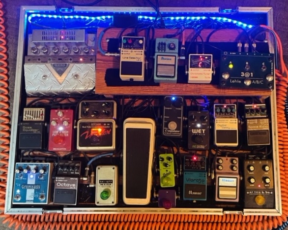

That's pretty rad!
here is board for IceBear gig this friday for World Music Day - Aberdeen WA
The 3 way in switcher is something I never needed to utilize before but I'm switching instruments every 2-3 songs between 12string Bass, Bass VI and electric cello so this makes like so much easier!
