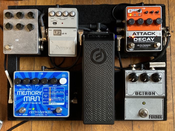

i've been narrating the continuing tale of tweaking my pedalboards into shape in the Gasaholics thread, but it occurred to me it would probably be better to do that here. i have all kinds of stuff going on, but the most recent serious thing to deal with was problems with my front-end board (aka "pre-processing board"...i call it the FEB because it's, well, at the front end of the signal path before the main board). this wound up being conceptualized around an EHX Attack Decay i got as an ILFSS gift and the octave box (since upgraded) i use for bass content on the loops. the most recent version went guitar->Foxrox Octron octave divider->EHX Attack Delay w/Moog EP-3 expression pedal->AD effects loop SEND->Ibanez LF7 Lo Fi->Zvex Instant Lo-Fi Junky->Fairfield Circuitry Shallow Water->AD effects loop RETURN->enveloped signal to Boss RV-3. the idea was to degrade and antique the signal before it went into the main board. however, i discovered a big problem.
when all 3 boards were hooked up together, something on the FEB was putting out some kind of EF interference that was so bad that it bled into the signal going to the fuzzes on the big board and made them about twice as noisy as without the FEB send even when everything on the FEB was turned off. this was a serious problem, so i had to diagnose and fix it. i made up a whole list of potential causes ranging from obvious to obscure and started going through the questions. first was a fairly inconsequential fix; i'd neglected to pay attention to the mA ratings on the power supply and thus the AD was seriously underpowered. so i made a list of everything on there by current draw in mA and rearranged the power outs so the 400 mA outs went to the AD and the RV-3 and the 200 and 100 mA outs got successively less needy pedals.
this didn't touch the main problem though, which was that two boxes--the Lo Fi and the Zvex Instant Lo-Fi Junky--were very noisy even when they were powered by separate 9V wall warts which eliminated the power supply being the issue. i suspected the Zvex because to my recollection it had always been noisy to the point of being irritating, and when i pulled it entirely off the board and ran it off a 9V adapter with nothing else between the guitar and amp it was horrendously noisy all on its own. so that had to go. once i got that off the LF7 was OK, a bit of hiss but nothing unusual for a gain-adjacent box. so now there was a rearrangement issue because the way stuff was laid out wasn't exactly optimal, and also the question of what to replace the Zvex with. i decided to pull the RV-3 and replace it with a EXH Stereo Memory Man w/Hazarai that this year's ILFSS brought me. so far everything appears to be working fine, though i haven't run the entire 3-board setup to be sure the big board's fuzzes are OK now. i spent a bunch of time setting up presets for the AD because without presets it forgets the expression pedal sweep settings, so now there's a general-use preset with my preferred EP sweep, a continuous-triggered wonky tremolo effect i can control for speed with the EP, and a preset similar to preset 1 but with the onboard "Harmonix" fuzz, a kind of Muff-ish severe distortion effect, added. i also fine-tuned the LF7 for the right kind of crispiness. i still have to figure out the SMMH other than obvious surface-level stuff but i'm confident there's some good stuff in there. the LF7 might get replaced by a filter pedal i saw Megan the shoegaze girl demo that's really great, but i'm trying not to buy things that aren't strictly necessary for now because i have several equipment needs and a bunch of medical bills to cope with. so this is what i wound up with. if i was feeling ambitious i might stick my GEB-7 EQ in there, but i don't think there's room now. so here's what i've got on the FEB today.
FEB 12-28-23.jpg (130.14 KiB) Viewed 3018 times

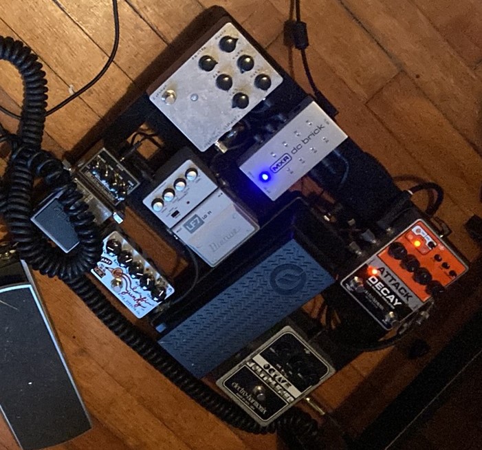

compared to the old FEB; this was before i had to replace the power supply because the Shallow Water doesn't get along with MXR power supplies per the folks at FC. yeah, noise has been a FEB problem from the beginning.
