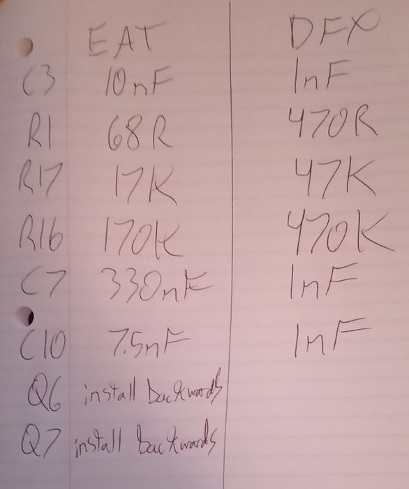

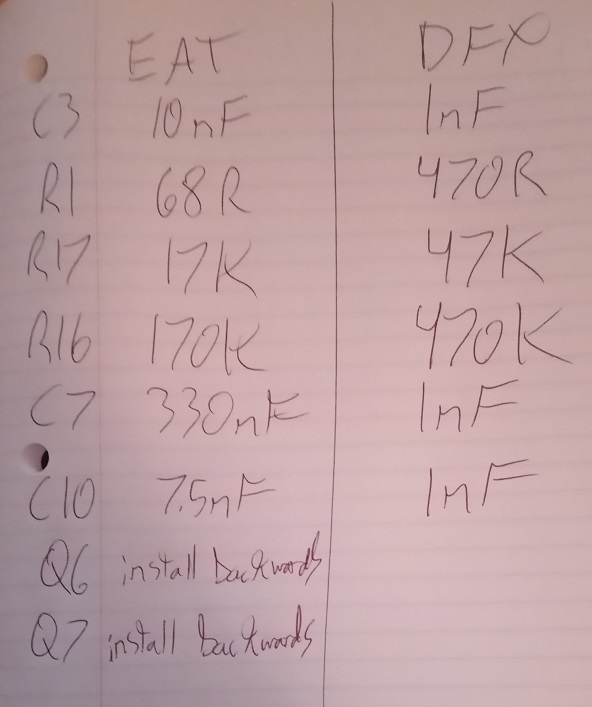

to anyone who already purchased a PCB from me. the correct resistor and capacitor values are available thanks to the contributions of Dead End FX. I could not have got this far this fast without the help of Dead End FX so I must give them credit for saving my PCB project and bringing it back to life. I know it wasn't done as charity to help me but at least they decided to go open source in the end after initially it was proprietary to dead end FX. R1 is not wrong at 68R but if you want less noise, more sag, you can use the 470R value as you will find in the dead end FX schematic. in this image you will find my mistakes on the left and the possible solutions on the right. it should be noted that these are the opinions of dead end FX and not necessarily the values found in the INFANEM pedal. With that being said, I would trust the experience of Dead End FX more than my own experience. I also don't have access to anyone at INFANEM who can confirm the correct component values. I suggest anyone who purchased a PCB from me use the updated component values on the right and install some hand picked high gain NPN selected for reverse gain in positions Q6 and Q7 (installed backwards to the silk screen footprint).
