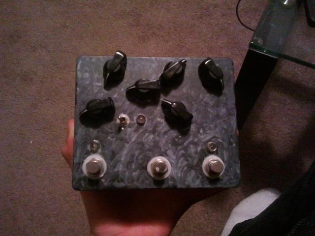

nieh
Posts: 2689
Location: Wisconsin
Post by nieh »
this happened as an accident, but I liked it to I kept it the same. I used a whiteout marker to label the knobs on my Dirge Super Hard Stampede a year ago, and I was using acetone and a q-tip to take of the white out and it made this effect. so I kept it like this. looks better in person.
