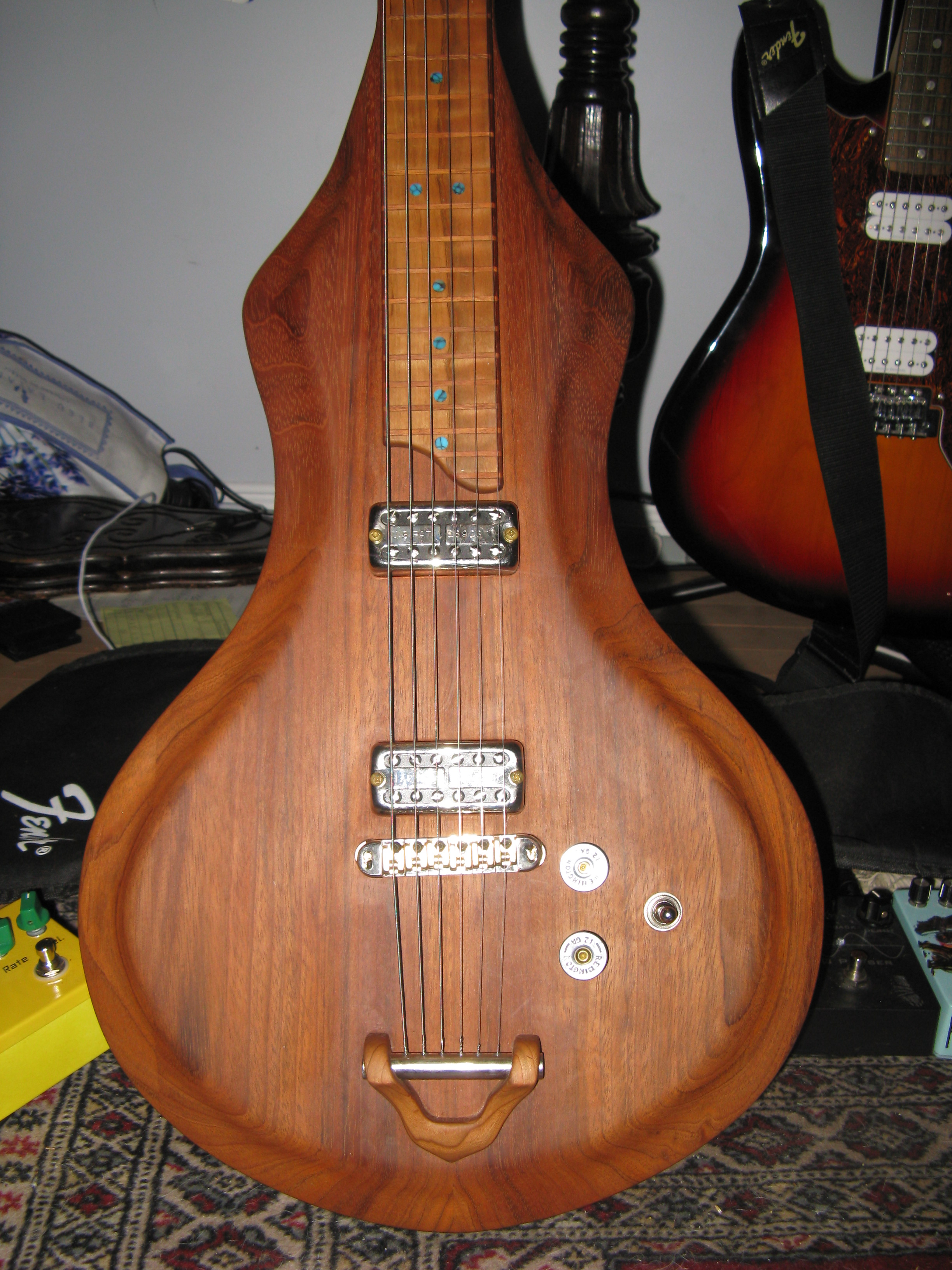

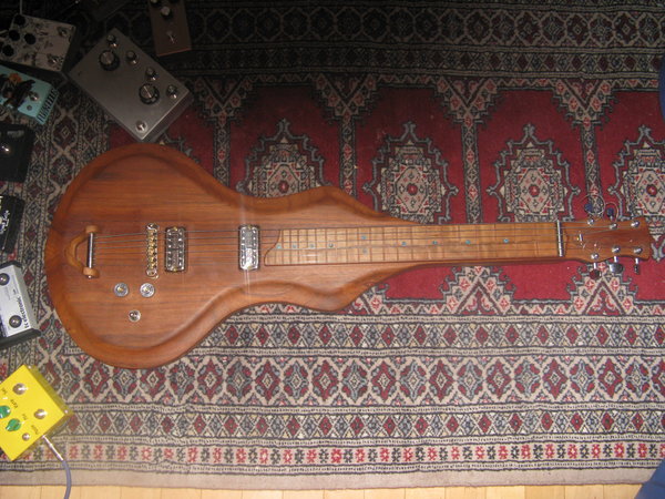

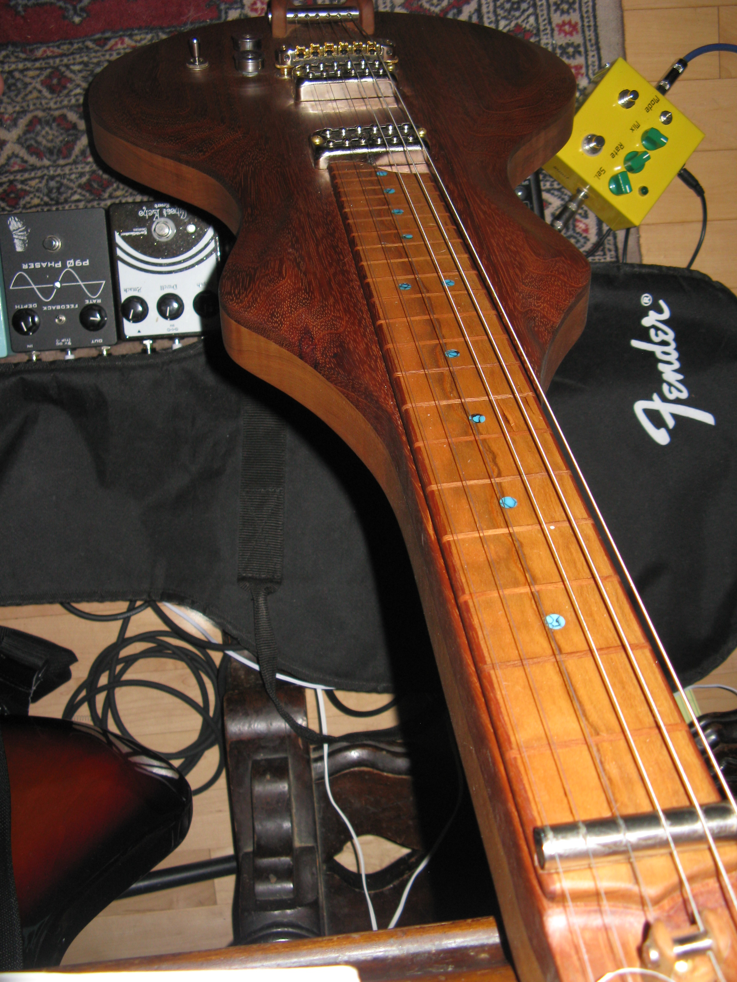

Latest build: cherry and jatoba with chambered body and hollowed neck, 500k pots one push/pull for phase, aerovox .03 cap, Sprague treble bleed .001 cap and 220k resistor, Filtertrons, turquoise fretmarkers, shotgun shell knobs, stainless steel nut and tailpiece....sounds real deep gonna put some baritone strings on it.

Nice build, lapsteel. :D
Re: Let's see your GUITAR!
holy cow lapsteel the details on that thing are amazing.
loving the fret markers
how do you make a shotgun shell work as a knob?

hbombgraphics wrote:holy cow lapsteel the details on that thing are amazing.
You can actually buy them, but they are pricey and usually have the primer removed. To make them you gotta cannabalize some crap knobs for the center sleeve, bandsaw shells to a nice width, fill with epoxy, find center drill it out to fit donor sleeve and laminate. Check out that telecastor website: www.tdpri.com/forum/tele-home-depot/234 ... knobs.html We all know how much tele players like guns....
If you can get your hands on some 20 ga, they are sometimes made of brass...

Thank you kindly, she sounds killer.

Yeah, that's one beaut of a lappy. :thumb:
Do you do commission / commercial work or is all your stuff strictly DIY?
This is my second lap (and my third guitar) but I expect to make one or two a year on my spare time. I will probably put some of them in the buy/sell to fund other projects. If everything works out I hope to make a bass lap with a built in dirt circuit....maybe some sympathetic droney strings too....something a little crazy....
