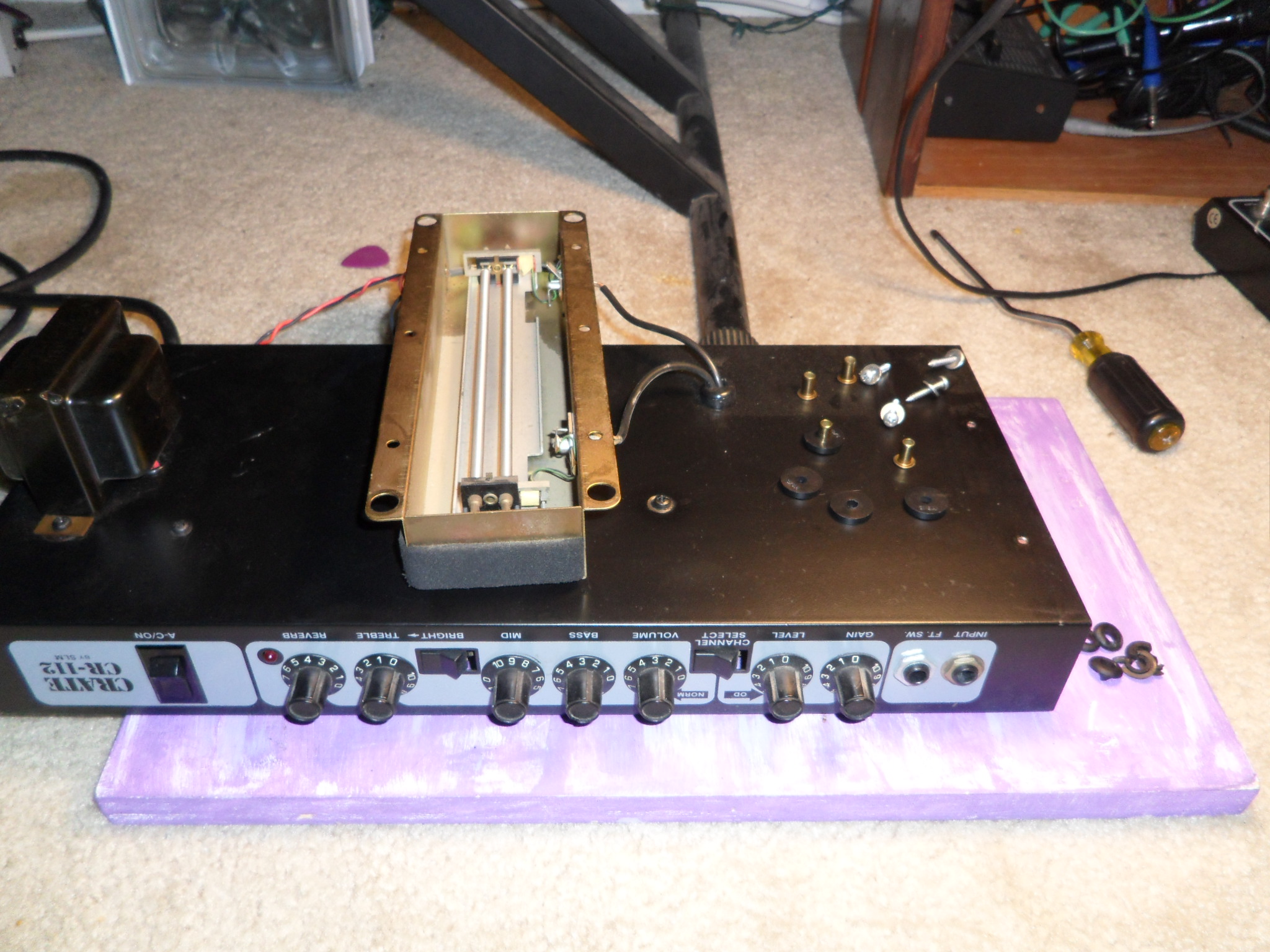

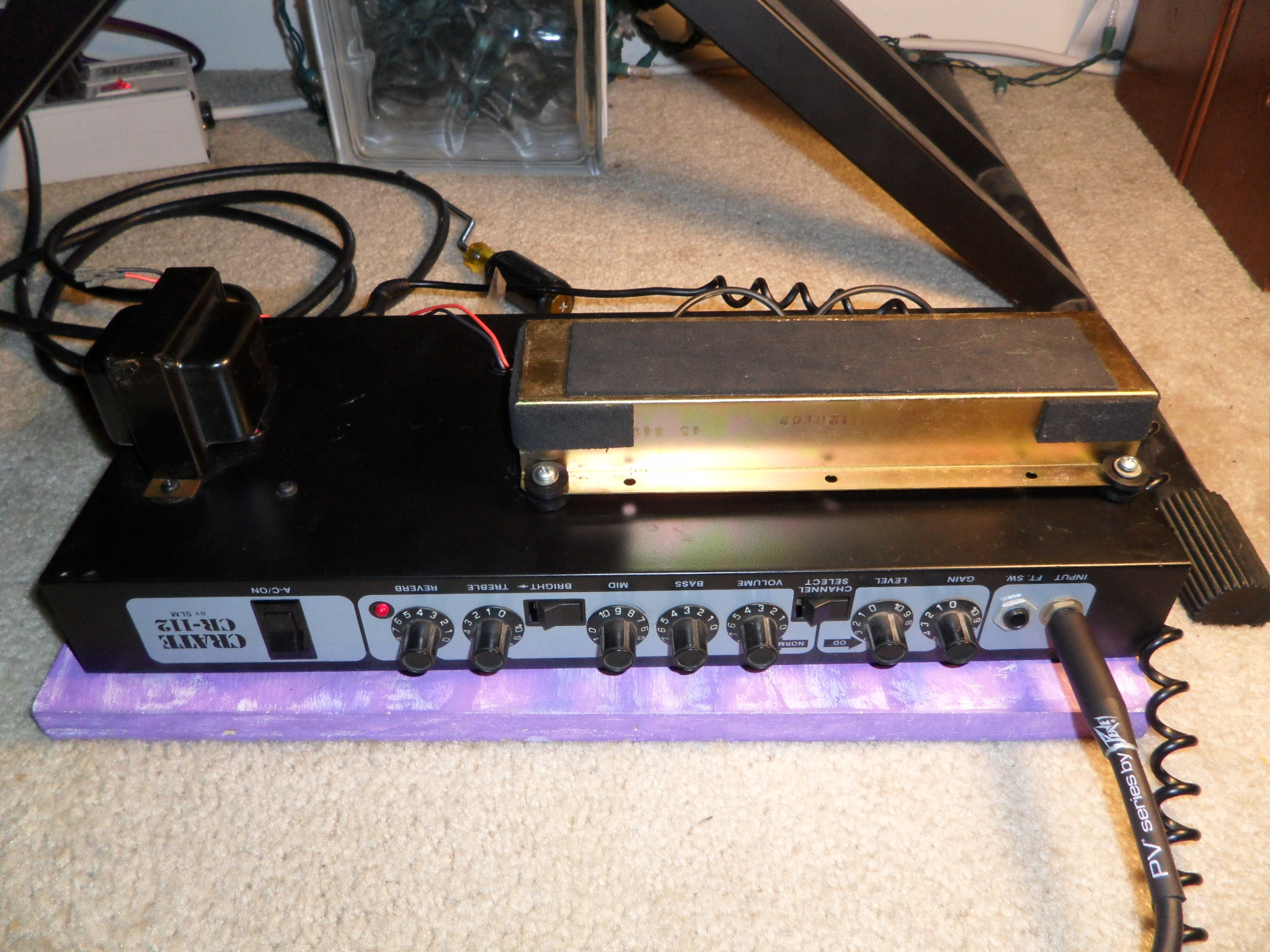

I use this lil Crate CR-112 "Head" I took out of a combo for a headphone and pedal amp late at night... I got the combo real cheap and eventually the speaker ripped and I replaced it with a Rockford Fosgate car 12" that I found in the street and that was ok but the Spring Verb was always too short... When I took the head out I saw the grommets were fucked so I looked around and found some ol sink washers I never used... They're kinda tight but when I plugged it all back in it seems the Verb time has doubled and the Springs have Sprung back to Life... I guess it's just the rubber support but it really bought this bitch back to life... Sounds SICK with pedals and headphones plus I can always put it back in a 1x12" combo... YAY $25 AMPS...
