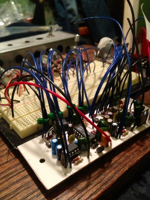

Been wanting to replace my old clarinot. Decided to do a two in one!
Gone Fission
Posts: 4961
Post by Gone Fission »
:joy: :!!!:
Details! Just two in series or special tricks?

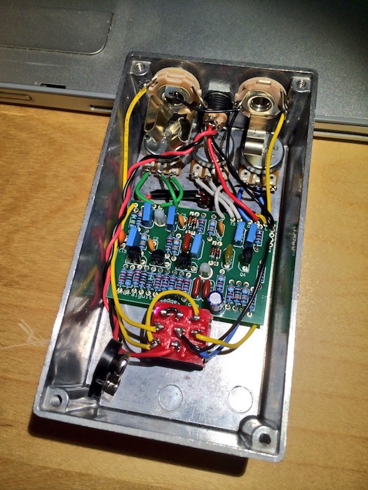

My first successful kit build (only build for that matter). From General Guitar Gadgets, this is a Triangle Big Muff Pi. I had attempted a Fuzz Face last year, scrapped the project because I couldn't debug it for the life of me. I have a long ways to go with all this in general. Anyways, this pedal, I took a shitload of time to do and was extra careful and I think I got extra lucky because it worked right out the gates. It's the big muff I've always wanted.
Side note: any suggestions for information regarding perf board building? I'm perusing all of the info under the DIY Info Collection post, but figured I'd dig for any other useful info. I'm brushing up on schematic reading now, I figure that will help me the most.

LaoWiz
Posts: 2035
Post by LaoWiz »
Gone Fission wrote:
:joy: :!!!:
Was gonna do two in series but after testing the first one thought that was a dumb idea. Probably A/B and just have different settings for each.
