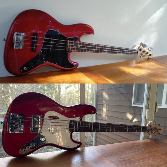

Completed!
The pickups are awesome! The custom Rio Grande is really something else, the switch is for series/singlecoil/parallel all the sounds are very distinct. The Gemini thunderbird pickup very mid forward where the Rio Grande is pretty flat. Mixing them in different combinations and settlings is a lot of fun.. the hipshot kickass is a lot heavier than a badass… I got of those extra thick stainless neck plats telecaster nerds like, I modified the no-mod thumbrest by drilling 2 countersunk holes so it fits over the pit bull adjustment screws..and I had a custom water slide decal made
Overall I’m pretty happy, the peavy neck is similar enough to a musicman so it plays how I like. The idea was inspired by mixing Mike Watt’s reverend and a Mike Lull jazzbird. I wanted something that was passive, massive and flexible, it looking cool was a accident
I just didn’t want to finish anything and I had the body…
Side note: Rio Grande is now using a picture of my pickup for the non black version of the pit bull 5 on thier site

i’m going to have to go back to middle/high school for an appropriate reaction: “BOSS, MAN!” how does that thumb rest position work? seems a wee bit tight to the E string. and that bridge looks like it could repel artillery fire.
are huge, massive bridges a trend again? i just saw someone selling new Gibson/Ibanez-style “harmonica” bridges, embedded brass sustain block sold separately. always wanted to try one of those. the Kluson bridge for my Tele, which is apparently plated brass, could kill a small animal if thrown edgewise and probably seriously wound a small child.

Thanks!
The zero mod thumbrests are shorter than a normal fender ones, it isn’t much higher than a pickup. That’s why I went with it and was actually planning to make I own if I hadn’t had found it. I wanted it to be like putting your thumb on the edge of a pickup for comfort and to protect the edge of a pickup built like a guitar humbucker..
I think there is a trend going with badass resurgence, alparts bought Leo quan and reissued a few of the designs, fender is now making their own “high mass” version and hipshot has thier version.. honestly I got this because I wanted a brass bridge that could be setup to 17.5mm spacing.. and nostalgia… I do think I went overboard with the bridge and the medal knobs… bass weights a ton now…
on a side note, I hate bridges with a lot of adjustable elements, something always comes lose at the wrong time.. so once I got the string spacing where I wanted it I poured red locktite in the saddle slots.. it would take a heat gun to reset now..

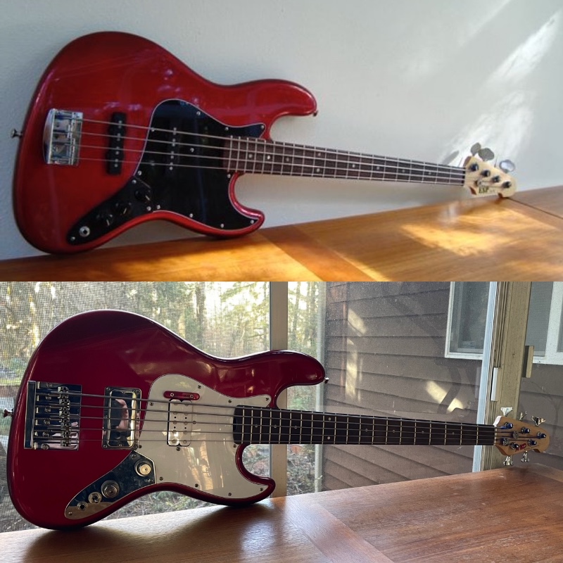

There is that
Before and after shot

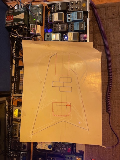

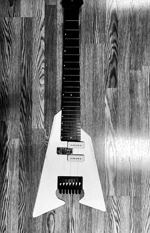

Keep in mind, that’s a Conklin 7 string BASS neck.. this is not small…
ignore what I was posting.. if you aren't already..
due to Headlessusa not stocking kickstands anymore.. I went full star..
Also.. bought a cherry body blank 18"x28" have a picking being made by Sentell, for a wiring diagram made up..m have some wedge coming that will either be a top or pick guard..
