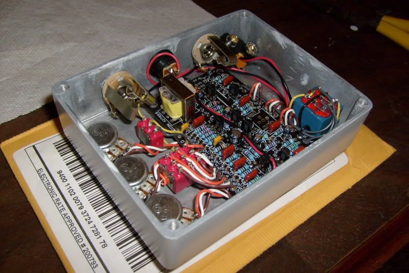

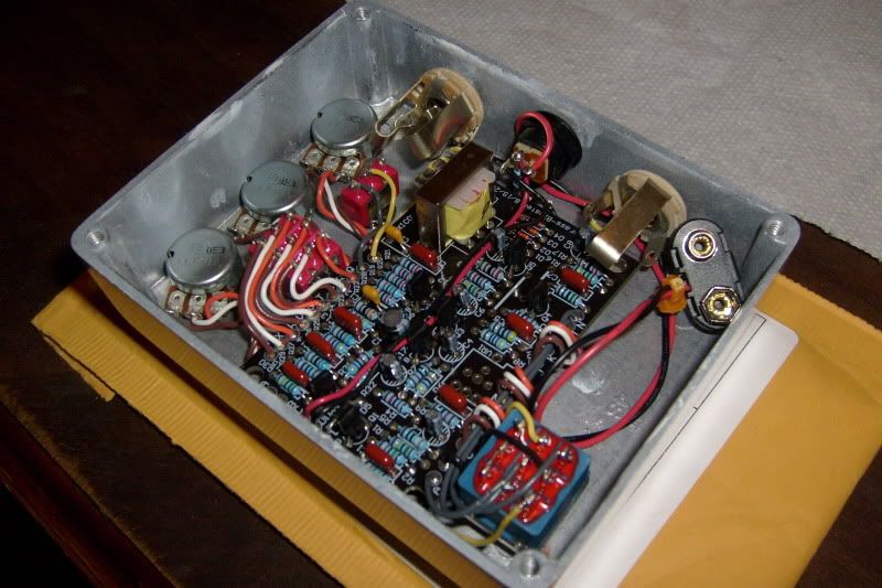

^Your stuff always looks nice, man. I'm fairly jealous. :cool:
Meathead:
Still need to get some knobs and trannies to play around with.
Also, I probably need to get some knobs and different transistors for this thing.

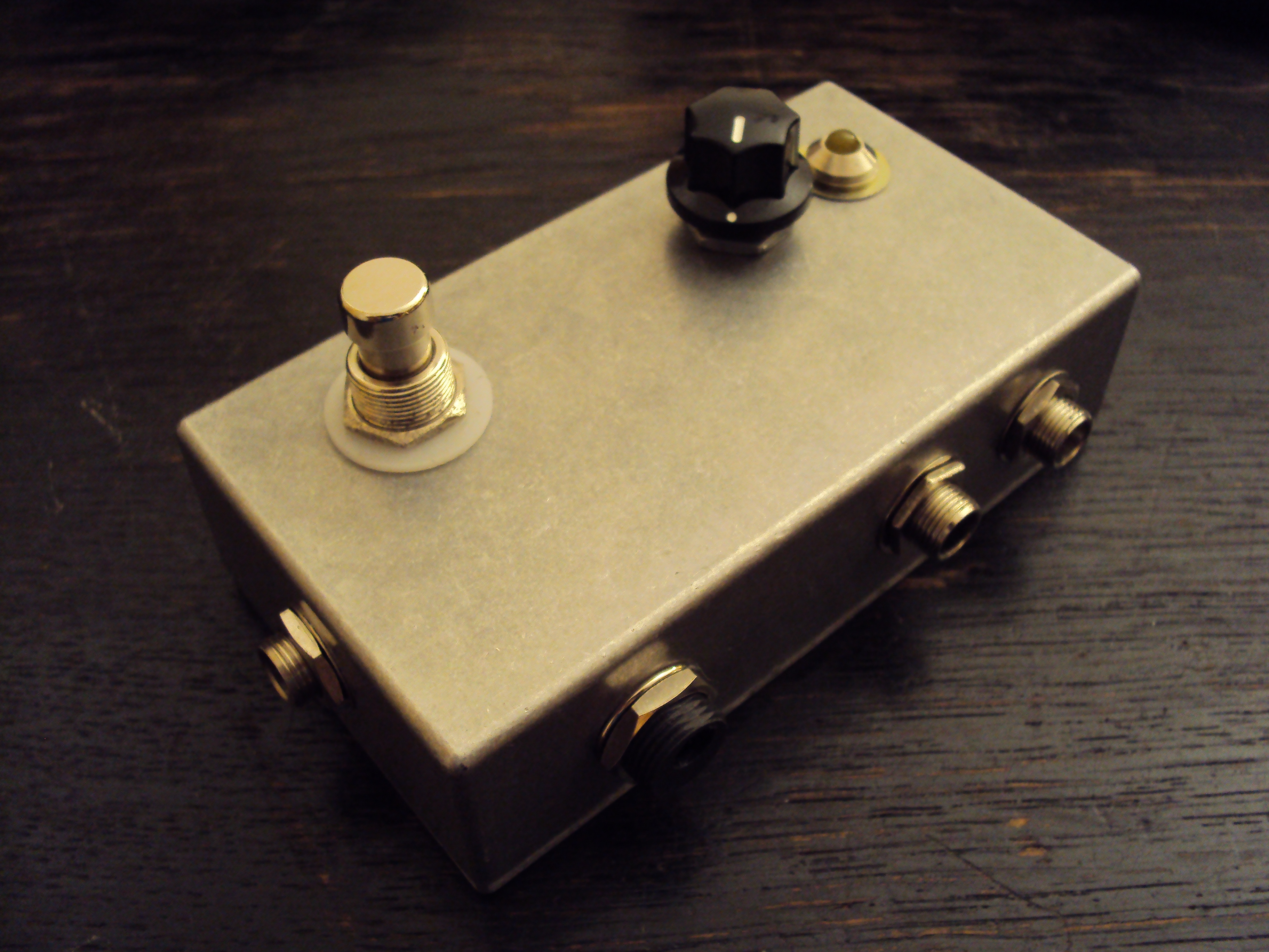

Not very impressive but I'm happy, my first working DIY build. Single Bypass Loop. My first was a BYOC Slowgear clone that just completely died somehow.
Outside
Innards
As you may see, I drilled holes without looking properly so had to move stuff, and use the large label to cover those original holes but I think it worked out well.
I also wired the LED the wrong way round and couldn't figure out what I'd done, but I have now.

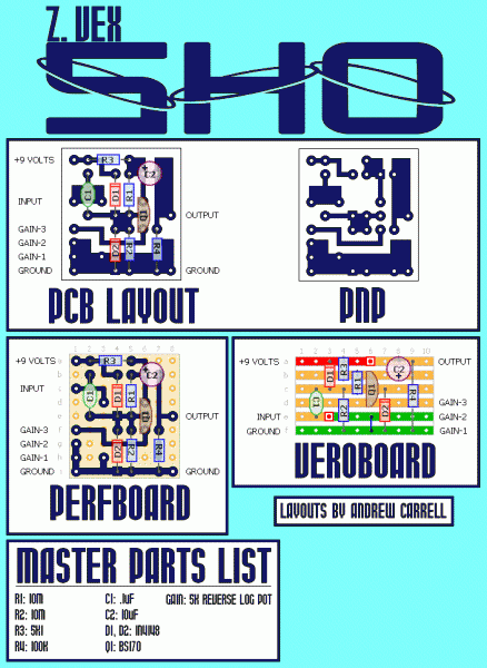

sho clone made using this layout(vero)
fun and easy build.
also really happy with what it does for my guitar signal
even at low settings.
