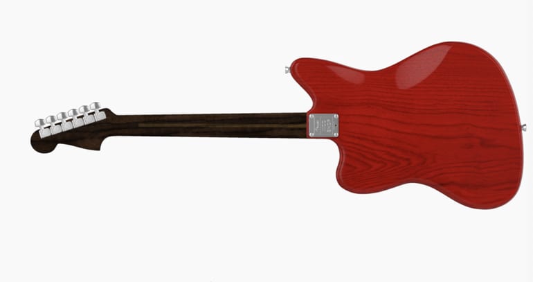

This fender tho.

Back shot required for effect:Inconuucl wrote:
This fender tho.
- Gone Fission
- Posts: 4927
Re: 2020 Happenings! (Post-Namm Depression)
Is that a fixed model or custom? I caught some mention of full rosewood necks being available as a custom option on a bunch of Fender models. A rather exuberant way to celebrate the recent CITES exemption.
Solid rosewood used to be a thing 20-30 years ago but fell off a bit. Roasted maple seems to be the thing these days. Still curious to try a full rosewood.
