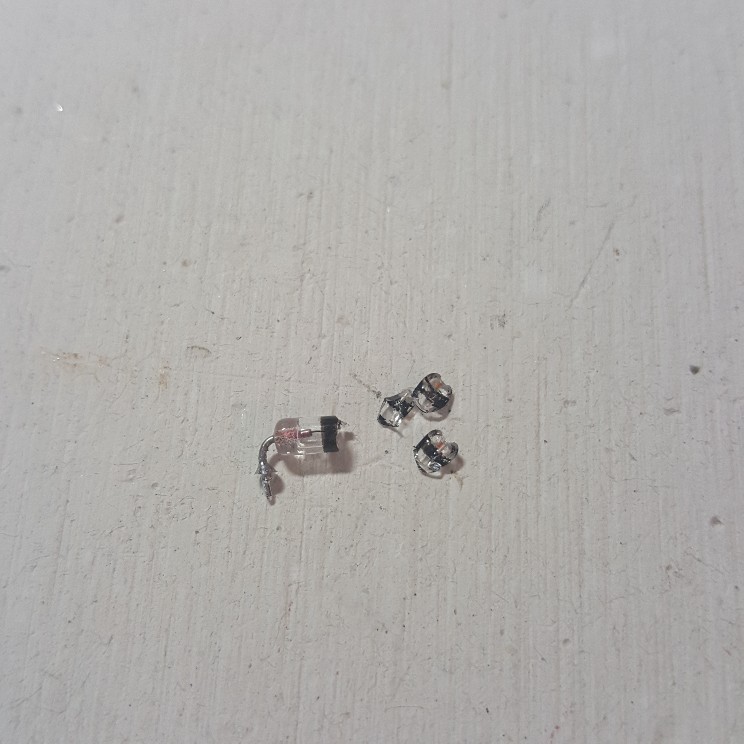

So I think I have my problems traced to what is labeled "D2" on the board, but D1 on the schematic. I'm at work but when I get home I'm going to pull that out and see if the 1N34A is damaged or in backwards.. it looks like its oriented correctly from the pics I have and the schematic, though I cant see the traces on the backside of the board. I'm no electrical engineer, but if it's not working correctly then both sides of the cap can "charge" eventually which makes the difference between the two sides much smaller, aka higher speeds (Faster discharge). Which may account for why the "minimum" speed on mine increases as I leave it plugged in. Maybe I should get in the habit of testing any GE components before I solder them in.. The 47k, 56k, 10k and 470R around the location all check out as proper values, though I did not test them. If the diode does not solve the problem I'll have to look at them. Anyone like debugging from schematics?

Careful about overheating Ge/point contact diodes.
You might be able to beep test the 1N34 in situ (I'm not looking at a schematic so I can't see pitfalls with that).

crochambeau wrote:Careful about overheating Ge/point contact diodes.
I'm not confident in my equipment to test the diode attached to the board. I have a weller with a pretty fine tip, and I've been running it at about 600 deg F for this board. The 470N came out no problem, so I'm going to pull the diode and put in 2 sockets and then if I figure out it WAS the diode I'll audition a few

- BetterOffShred
- Posts: 3412
Re: B.o.S. builds a Gristleizer
Uhhhhh! Straight up G bitches!!
But seriously. Just what I suspected.
Slow as a mother fucker now. I'm going to go try it. It's
- BetterOffShred
- Posts: 3412
Yep. That was it. Everything works now. I managed to dial out the tick on all but a little on the triangle wave setting. I ordered some D9E diodes from Bulgaria a couple weeks ago to use in the Sputnik clone Dino made (which I bought a board from him for.. ) so they showed up today .. one is now happily taking the place of that broken 1n34A .. more to come!
