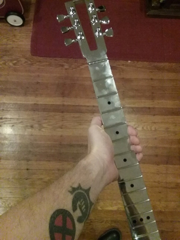

Benn Roe
Posts: 689
Joined: Fri Jun 17, 2016 5:36 pm
Location: Philadelphia, PA
Re: I want to build a guitar, but have no experience doing s
Post by Benn Roe »
It begins...
Current Bands: Leylines
morange
Posts: 1389
Joined: Thu Oct 22, 2009 3:50 pm
Location: Bellingham, WA
Post by morange »
Man that neck looks sweet.
