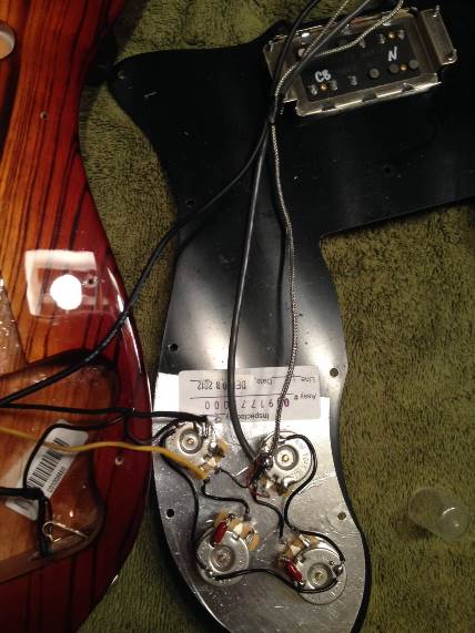

Re: Tube question / guitar tone
Anybody could tell me if the wiring looks OK?
Pot are 250k.
Yeah dude. The wiring looks fine. What are the potentiometer values? You kind of have a good thing going with individual volume and tone knobs for each pickup, because you can swap out the bridge pickup's volume/tone knobs for lower values without affecting the neck pickup. If they are 1M pots for the bridge, try to go down to 500k. If they are 500k, try going down to 250k!
