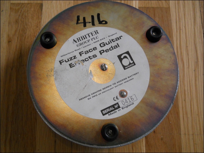

Found a Fuzz Face, no idea what its age or value is.

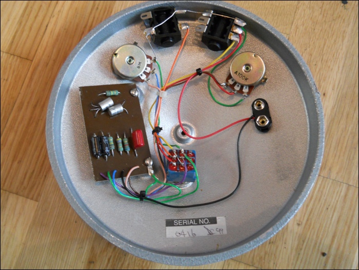

FF's aren't buffered bypass unless they are some Dunlop abomination best not mentioned (or the Classic Fuzz, which seems okay). The switch is a DPDT, so I'm assuming true bypass wiring.
If you solder, you could try reflowing all the connections, especially if anything looks particularly dull. You might get lucky and fix continuity on the signal path.

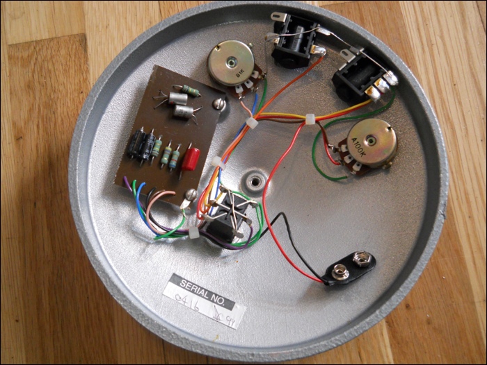

just got it, haven't plugged it in yet to test but here are some pics!
nothing looks amiss so maybe just a bad switch? we'll see!

transistor 1 was indeed soldered in at the factory the WRONG WAY ROUND!
board is working fine now i switched the transistor round but the fuzz isn't passing through the switch, will investigate this today!

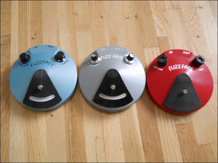

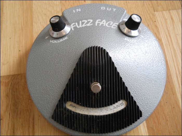

so this is where the 2013 dunlop fuzz face gets its design from 0.0

Just to bring the thread to a happy ending, Fuzz Face is fixed, new switch, new battery snap (floppy one fell apart while working on it, replaced with hard plastic one!), and transistor 1 soldered in the right way round!
Actually doesn't sound too bad as well!
