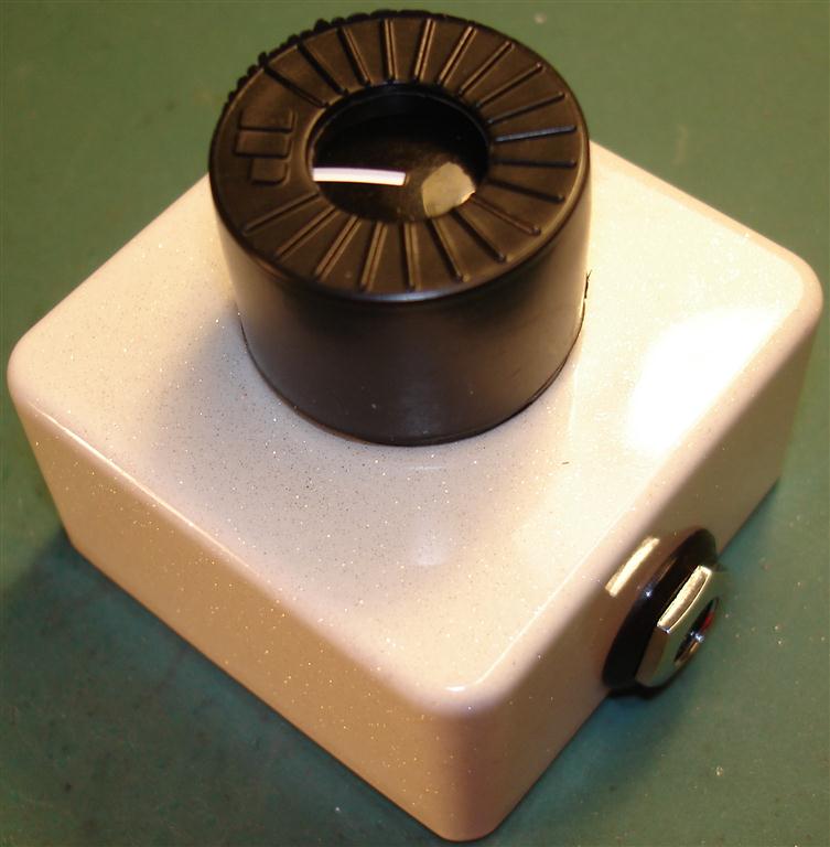

how about a potentiometer with a soldered Jack at the bottom that plugs straight at the side of the elements. and the Potentiometer cap would be big enough and higher that the Element's casing so that sliding it with your foot would be easy? the potentiometer cap would also need super luminous thingy around it that would be indicating how much have you adjusted it?

That's a pretty cool idea, plugging the pot with a big knob attached to a plug right into the mix jack... I don't love the power and lighting requirement idea since the mix control is just passive and is much easier/simpler without all that... but a big knob you plug into a mix jack is a pretty cool idea!

Here's Brad's white sparkle mix knob in a box:

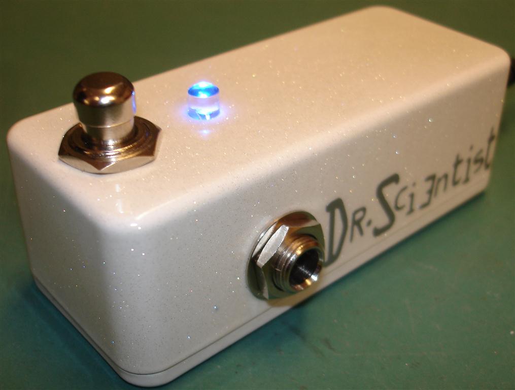

And Andy's soft touch buffer in a 1590A:
Thanks dudes!
I'm out of white sparkle now but if people want more I'll get more, no problemo, just takes a couple weeks.
Thanks dudes!

I just scared the bejesus outa poor Ryan with the buffer!
All my pedals are true bypass and I wanted a buffer to maintain the signal right the way through the chain. Unfortunately in my ignorance I'd always kinda assumed a buffer actually boosted the signal through the chain! I know doh!!
So when Ryan sent me a pic of the above buffer last night I then proceded to ask how much boost it had! I know I know
so I then had poor Ryan thinking I'd wanted a boost and not a buffer and that he'd built me the wrong pedal!
Big doh!!!
So after explaining to me exactly how a buffer does work all is now right with the world and panick over!
so I then had poor Ryan thinking I'd wanted a boost and not a buffer and that he'd built me the wrong pedal!Big doh!!!
I'll keep me gob shut next time!!

You won't regret it. A good buffer and a bunch of TB pedals is the best combo out there.
