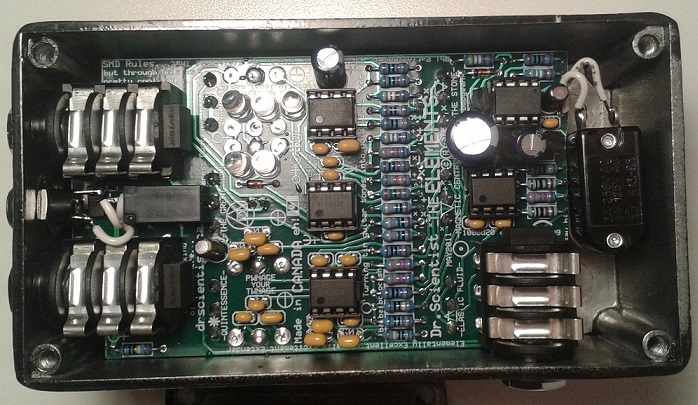

Elements #55 showed up in the mail today. Plan is for it to cover the dirt spectrum between my FB-2 and Oxide. Haven't had a lot of time to play with it, but I have noticed a lot of noise on high gain settings. I'm not sure if it's my rig or the Elements though - which units had the grounding noise issue?

Re: The Elements, favorite settings, post them here!
So is the fix just tying board ground to chassis ground? Is there a particular grounding point that works best?
Sorry to hear about the noise! If you show us a pic of the inside of your box we can see if it's grounded or not and then show you the right tabs for ground. Super easy fix. It won't silent it though, it's still got a lot of noise with the gain knob over noon in high gain mode, just comes with the territory of how high gain the pedal is.
Doesn't look like anyone's done any extra work. I've got plenty of solder/wire/copper tape laying around; what's the fix?
Totally, that sucker's not grounded! Sorry! *smacks forehead again*
The easiest place to get at ground is the tabs on the in/out jacks, the closest tabs to the enclosure edge are ground. You scuff up some of the metal inside edge of the box near one of those ground tabs, get it shiny and scratched up nicely, then stick a little piece of copper tape down over the area, like a half inch kinda thing. Then take a short wire and solder one end onto the big folded ground lug of the jack. (Be careful to not get too much solder on there as it'll roll down and solder your jack closed!) Solder the other end of the wire to the copper tape. Boom, grounded Elements!
Now the other thing about your Elements is it's the very first run and it's tuned a little hot.. it's noisier with the gain knob at noon than today's Elements would be.. you might find you use this badboy with the gain knob set a lil lower, or we could go over a resistor change or two to lower the gain of that stage. Personally, I think that version ripped the hardest and I don't really care about background noise, that kind of gain is for palm mutes and power chords, not silent parts, but I neutered it in the next pcb round to bring the noise level down. *looks down and kicks a rock*
Loztboy wrote:I did a little quick and dirty grounding "mod", on my trem and Elements, and now they are as quiet as it is in outer space
I may have voided my warranty tho, here's a photo of the little "mod"
It looks cruel but it works for me
Cool, simple enough mod, but I don't have sandpaper so this'll have to wait until tomorrow. Have you noticed if it makes a difference whether both jacks are grounded, or just one of them?
All you need is one.. the jacks are both grounded it's just that the enclosure isn't, so one path to ground for the enclosure is all you need. I suggest something like needle nose pliers to scuff up the metal inside the box, really rough it up so you get a great contact. Sorry again for the repair work!
The pliers worked just fine. Mod is done, seems quieter, but yeah there's still noise past 11 or so on high gain. No big deal. I'm not upset in any way Ryan, I know what it's like to mess up on a board. I've had that stack of dead PCBs sitting on my desk. That's life.
