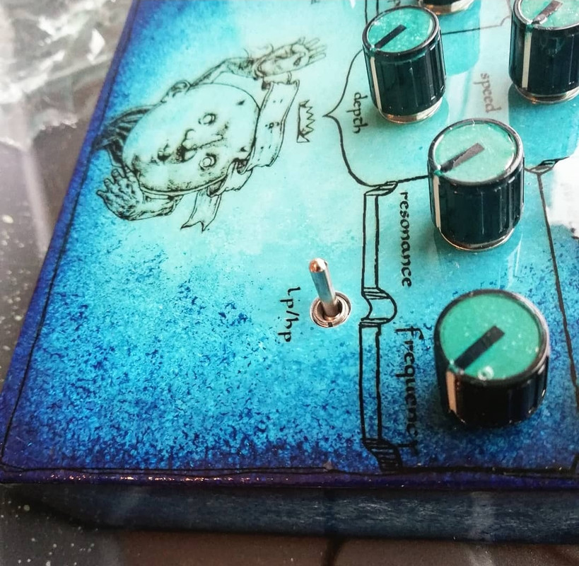

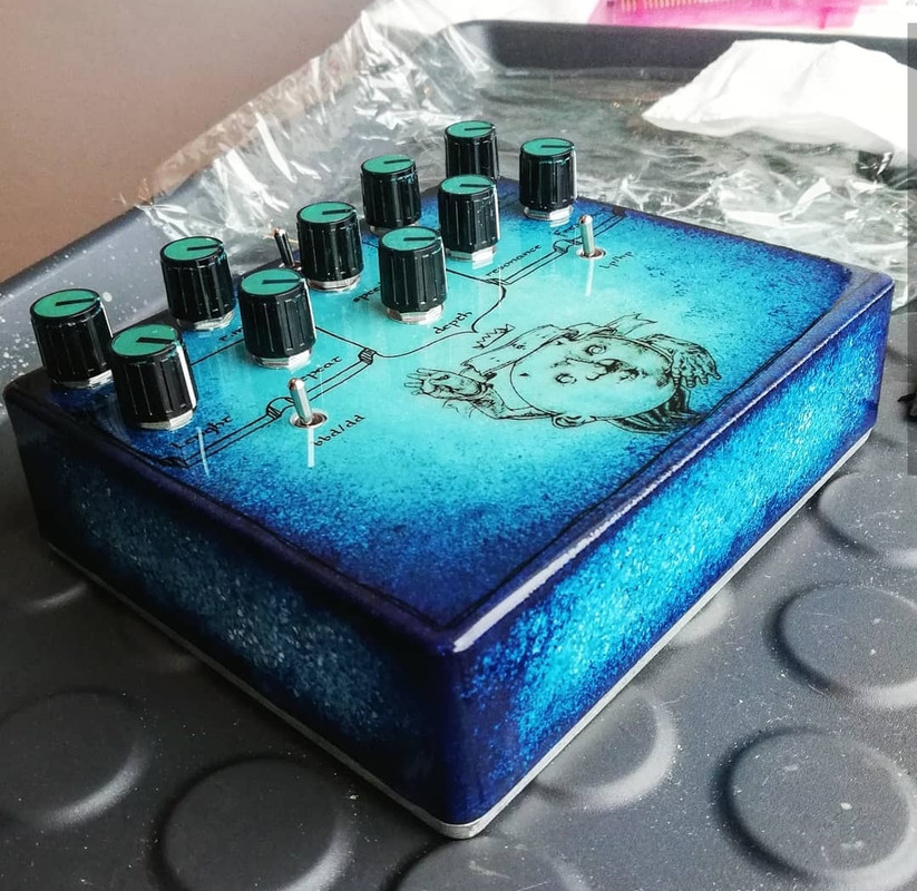

Here's my new baby. An homage to the never released Sonic Crayon Mechanical Sun, this is the Digital Flora Biological Moon :lol: :joy:
Selection between a 20 second delay (can do 40,but even 20 seems overkill. Might make it 10-15) or a shorter BBD style crunchy lofi delay into either gooey pitch modulation or pulsating amplitude modulation that goes into ringmod territory. Next up is a resonant 2-pole high or lowpass filter and an ambient reverb (based on Clouds) with controls for room size and smearing. No bypass shit. This baby is always listening and recording and I use the d.mix and r.mix to bring the effect back in.
Pleased! Will make more! :snax:

That looks amazing.
With Axoloti, the temptation is to leave it open-ended but I like the idea that you set it up as a single-use device then build a different one for a different purpose.

Thanks!
Yeah, I guess if you went for a rotary mode switcher and/or an OLED solution you could make it do everything and more, but I liked doing it this way. Definitely had to remove bunch of other cool effects along the way to keep it relatively cohesive and 'simple', so making another that's different is on the horizon for sure.

UglyCasanova wrote:Selection between a 20 second delay (can do 40,but even 20 seems overkill. Might make it 10-15) or a shorter BBD style crunchy lofi delay into either gooey pitch modulation or pulsating amplitude modulation that goes into ringmod territory. Next up is a resonant 2-pole high or lowpass filter and an ambient reverb (based on Clouds) with controls for room size and smearing. No bypass shit. This baby is always listening and recording and I use the d.mix and r.mix to bring the effect back in.
Where's the clips tho. ;)
Not that you should change this at all, but if you haven't tried it make sure to check out the TSG reverb. Lovely sounding, lots of knobs, and you can turn the diffusion down to get a delay or smeary reverb. My favorite.

Holy f Kent. Amazing job
