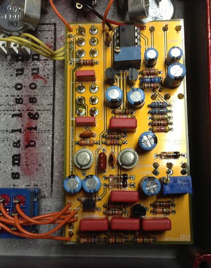

well, no dip switches, blue boxes with what appear to be adjustable screws....over my head here. there are $$$$$ and a Who loves Fuzz?? also says this is version 3.6pnp 2010.

• Internal trimpots: Two internal multi-turn trimpots. These are set for the best sound as i hear it,
but feel free to change them...
--bias trim: Adjust the bias of the second transistor. Helps to cancel noise, increase/reduce bass,
tame feedback.
--feedback trim: Adjust the amount of negative feedback. Changes frequency response, amount of
feedback.
tame feedback.
feedback.
so are those blue boxes the internal trimpots???????
neonblack
Posts: 8090
Location: Wilmington, NC
Post by neonblack »
Hmm. I've haven't seen trims that look like that. Send that picture to Brian, he can probably tell you.
Schlatte
Posts: 2667
Location: Austria
Post by Schlatte »
Uncle Grandfather wrote:
tame feedback.
feedback.
neonblack wrote:Hmm. I've haven't seen trims that look like that. Send that picture to Brian, he can probably tell you.
Yes, those blue boxes are trimmers. Real nice high quality ones, to be exact :thumb:
I think I can even see the word "bias" silk screened to the one next to the IC?
Schlatte wrote: Yes, those blue boxes are trimmers. Real nice high quality ones, to be exact :thumb:
yeah it says bias by the top one. thanks for the input :thumb: i'm going to assume these are the two trimpots neon posted about but maybe to be safe i'll contact Brian and make sure they were meant to be user adjusted.
