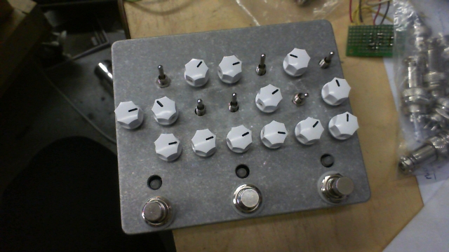

- multi_s
- Posts: 2098
Re: << mtl.asm >>
Here 's a pic with the proper drill pattern.
we will be at thw stompbox/synth exhibit at SXSW in austin in a few weeks so we will debut it there. we will have most of our pedals there to try.
