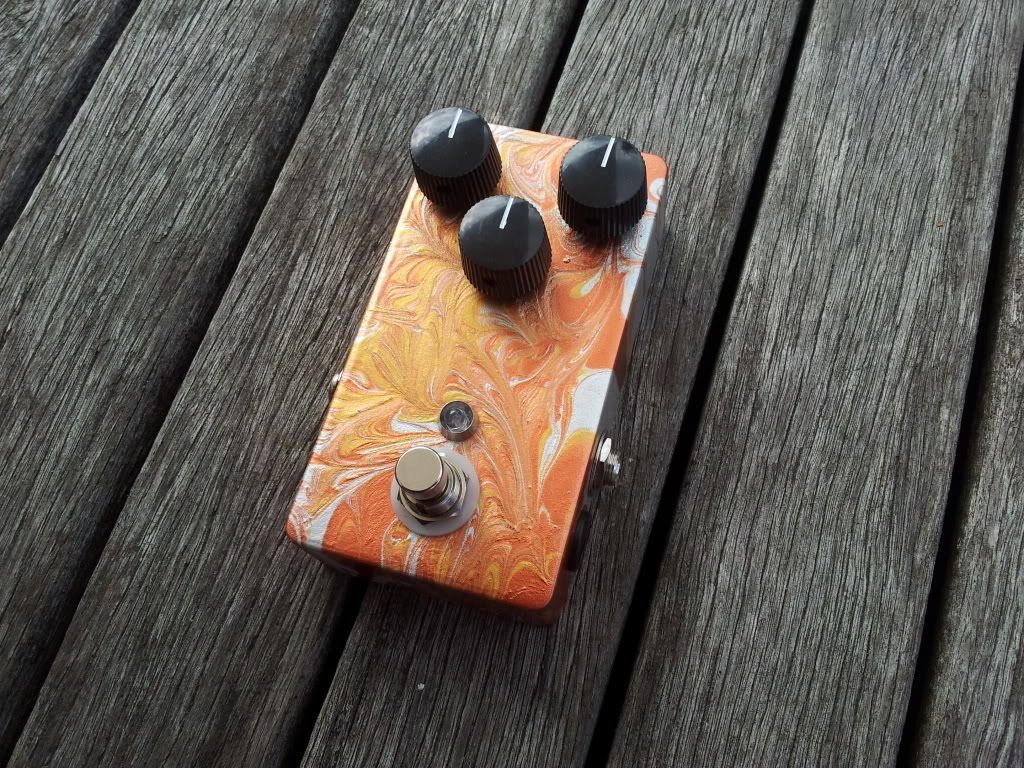

slapback delay/reverb.

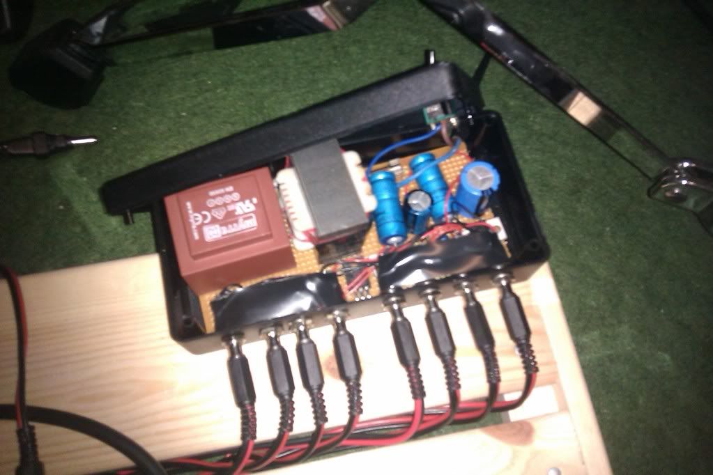

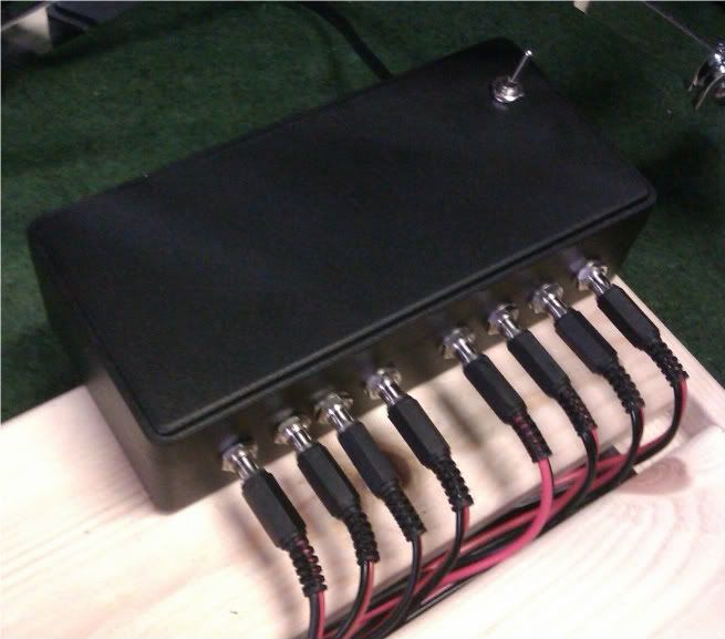

New Power supply. Takes mains voltage and puts out 4*2 isolated 9V outs (two power rails with two isolated outputs per rail).
Finally enough juice for my babies :thumb:

plastic chasis?

Post by Schlatte »
^yep.
Gotta double insulate when working with Mains supply.

do you have pics of the inside? im just interested in seeing how people diy supplies. i built a few about 8 years ago that i want to replace eventually with something snazzier.
edit: also you may want to make your dc connectors with coaxial cable instead of untwisted pair, particularly if the power supply chasis is plastic to reduce emi.

Here you go:
Nothing snazzy about this one... just Mains in- two power transformers (2x12V per transformer)- 4 bridge-rectifiers -4 big electrolytic caps- 4 7809 voltage regulators- 2 outputs per regulator.

multi_s wrote:edit: also you may want to make your dc connectors with coaxial cable instead of untwisted pair, particularly if the power supply chasis is plastic to reduce emi.
Yeah, but I didn't have any coax at home... and that stuff is expensive... that untwisted pair cable is cheap...
On that note- I hate soldering DC Cables.. idk why.. but I feel like those DC jacks are a pure pain in the butt.
