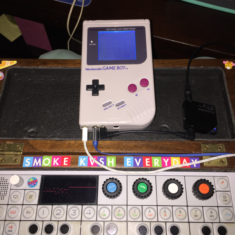

just finished up modding my gameboy.
direct out for nanoloop mono, passive extra input for jamming w/ friends, internal sync in jack for syncing up w/ analog clocks (pictured synced up to OP1)
swapped a couple caps for larger ones for bass boost on the pro sound output, and put a decoupling cap on the power regulator to clean up some noise as well.
:yay:

Dr. Sherman Sticks M.D. wrote:just finished up modding my gameboy.
:yay:
Amazing! :love:
Posts: 4049
Location: rochester, ny
well i broke the b button in the most obscure way possible :mope: (chipped off a tiny tiny super tiny piece of the board and broke the trace)
but then i fixed it so somethings happening :animal:
