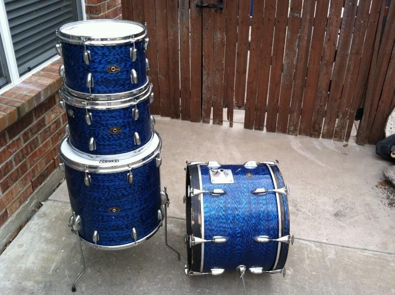

i had a deal on a premier bass drum go south recently and it left me wanting another drum... a random late night search leads me to one of my dream finishes on a slingerland set for cheap. so what do i do? i caved and now i need to clear some space in the jam room.

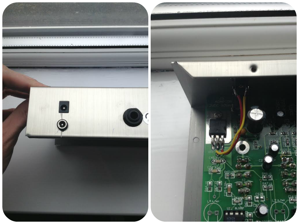

In: Flanger Hoax. This thing is incredible. I took the liberty of modding it to accept a standard 9v DC tip-ve supply. Sounds identical to with the EHX one.
Interestingly, the 18v EHX adaptors put out 22-24v (!)
Inside teh Hoax there is a 9v regulator (78L09) and I probed the circuit, at no point is there more than 9v going on.
So that was completely overkill, wasnt it, EH?! I swear they just put whatever fucking power supply in the boxes they have most of that quarter. The PCB even says 12v 100mA.
The pedal is supplied with, and says on the screenprint 18v 500mA. Whatever EH
Made a slight mess with the dremel but never mind, these EH boxes are really hard to drill so I have to dremel a pilot hole and slipped...twice!
For anyone that wants to do this mod its simple, wire the +9v to the right leg of the regulator, and the GND to the central peg.
It can still use the 18v DC supply. You could remove that from the board but its way more work.
Note you cannot do this with all EH pedals because some actually require higher internal voltages (usually regulated to 15v) and some are positive ground. Hoax is negative ground!
I also had to swap out the mix knob, now it all works great (mix pot was borked, only 0% or 100% wet)
Hardest part of the whole deal was getting the bloody knobs off.
